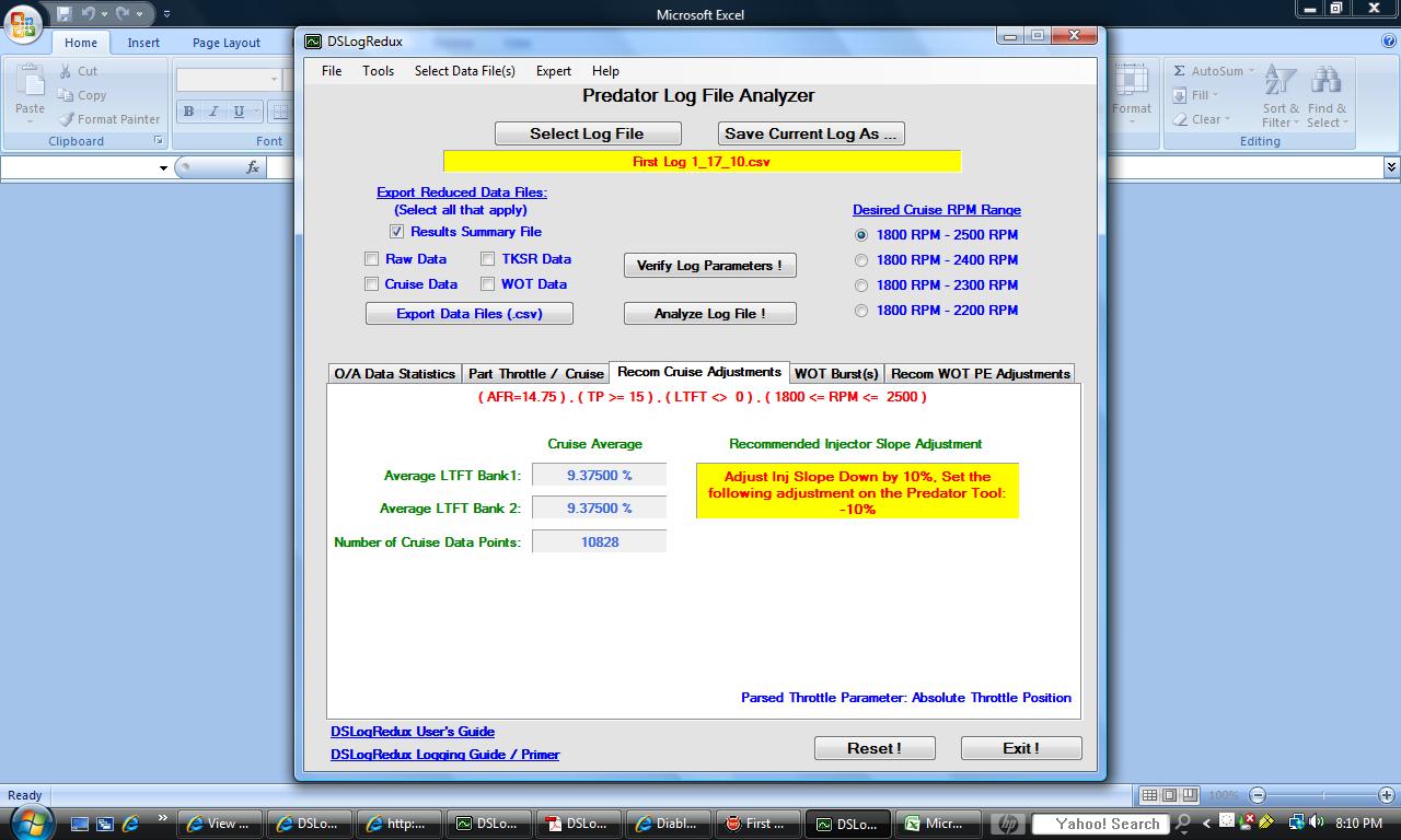

Looks like based on my first log, I need to adjust injector slope down by 10%. Does that seem reasonable? Just making sure that double digit adjustments are normal.

- Results from my first data log.
- 1st Log.jpg (121.45 KiB) Viewed 3226 times

is this a camaro??? Both banks are the same value, which, would be unusual unless this is a new camaro. For some reason the new Camaros do that, it seems.... If it is a good log, and there is enough data (which there is, otherwise it would not have even reduced it) make that adjustment, drive around for 50-70 miles and re-log and see what shows up.
No, double-digit adjustments are NOT unheard of ---- that being said, looks like your engine tends to want to run lean. CAI? Exhaust? Any leaks anywhere?
Edit: Just scrolled around and see this is an Avalanche. Can you post up the log?
I am a little unsure of both banks being the same average. THAT is a little unusual...

Appears that bank 1 and 2 do have varying values but their data at the end of the log seems inconsistent and all over the board. Is a longer log better in this instance? More logs to get accurate data? Also, if longer logs are better is it ok to merge logs to one larger .Csv file? My log was done on flat interstate at 73mph and I could easily replicate.
Just a quick thought when i was reading your story. How did you datalog? When i data log i drive up to 60mph then i put my transmission in M mode and shift 1 gear down so that it doesn't go in overdrive. When you say you were drivng 73 mph weren't you in overdrive mode? wich can cause that your valueas are differanct than in a normal gear?

OK... couple of things.
Bone stock + CAI : makes PERFECT SENSE that your trims are like that. The CAI allows more air in, thus the positive trims to get to the target AFR.
The longer the cruise log the better. As Solid infers, make sure that DOD (if equipped) is NOT kicking in during the log. One way to do this is to drop one gear and then drive such that your engine maintains 1800-2300 RPMs
during the log.
Interesting that things do fluctuate, but that the averages are the same. What this is telling ME is that the engine is running consistent on both banks. If you did your log correctly,
go ahead and make that adjustment, run anther 50-70 miles and re-log and let's take another look.
during the log.

Uhhhh, I take back what I just said (sort of)
Your LTFTs are welded at 9.375... 10000+ data points, and every trim is 9.375. This is what the Camaro folks are seeing as well.
Now I am getting a little interested in what's going on with the tools OR the
ECMs all of a sudden.... and this is an 07. hmmmmm
Lew, we have another welded log.

For what it`s worth, I also would like to see a new log (same parameters chosen) as Grumpy suggests! The STFT`s never go above 8 and drop to 0 at times, which would basically justify the non changing LTFT`s. But with the Cat temps so high and un-even, there is not much room for overtemp. This could be high due to the trims being out by 9 or so. it would also be good to see the same log after the adjustments. One other thing , he selected the full list to log and I do not see ECT in his log. I like to see and verify the 3 temp sensors, (garbage,garbage out)

Just making sure you want the same information logged--the "GM Gas General Short" list of parameters or is the "GM Gas General Full" a better indicator? I can replicate the same log by setting the cruise on the interstate at 73mph. My vehicle does not have DoD so that is not an issue and I was above 1800rpm. Would you rather see me drop down a gear in manual mode, assuming 5th and get to the 1800rpm range or what makes for a better log? I can try to accomplish this tonight and post later this evening.
I did not upgrade to v9r08 and my Predator is stock loaded with v9r07. Should I upgrade to v9r08, make adjustments to injector slope, and log again or would you rather see another log before I do anything?
