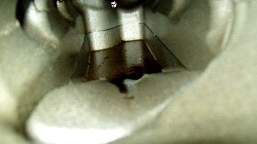

The Catch Can is needed if the truck EVER goes to wide open throttle. At WOT theres huge vacuum and it sucks oil into the manifold, through the PCV, where it pools. I have a pic some place of the inside of my mani when I took it off. I'll see if I can find it. With a Catch can, it goes into the can instead.

Oh, and heres the pic of my manifold. This was at 9,000 miles, right before my top end work. Twin catch cans went on at 3,850 miles. Now I only run 1.
