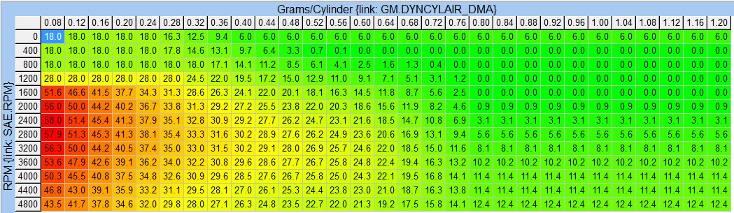

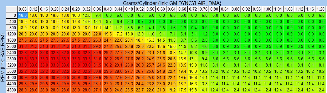

what is the base timing stock and what is the total timing stock..just numbers please. this should not be a secret, i just cant find info anywhere. thanks in advance. 03 silverado 5.3.
well its not that simple... but here are two pictures to take a look at, they are both base stock timing tables one for timing when in drive and the other for when in park/neutral. for total timing i can't help you out anymore than to tell you that there are two tables that the engine can choose to run on, either a low or high octane table.
- base in gear timing table
- baseingear.jpg (259.48 KiB) Viewed 3153 times
- base in park/neutral
- baseinpark-neutral.jpg (236.42 KiB) Viewed 3153 times
