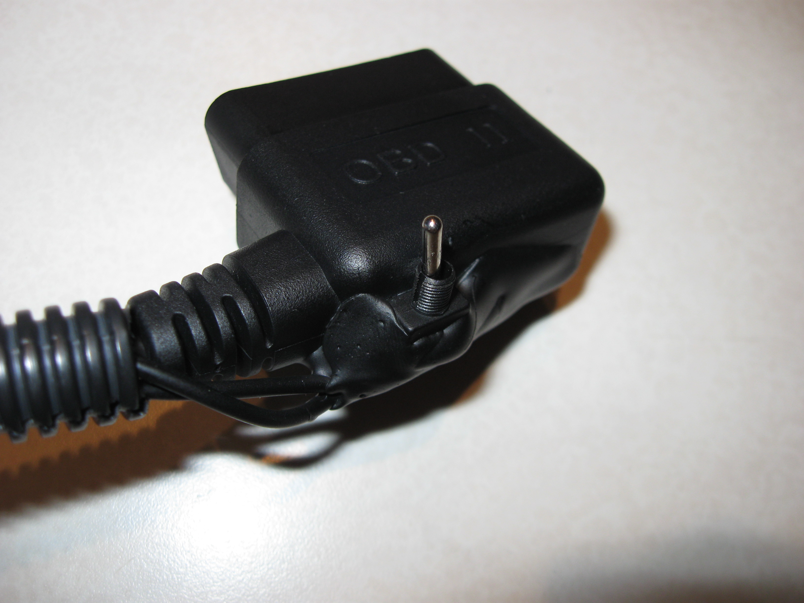

Thanks! Much appreciated! I have a new right-angle cable, and my new gauge pod A-pillar and Trinity mount... Monday, I'll modify the cable, install the gauge pod and Trinity, and not worry any more about draining my battery...TIGwelder wrote:Once again i'll step up and test something..<biting tongue>
I'll sacrifice a $25 cable to help myself and others
Now, if Diablosport could just figure out how to display oil temp on the Trinity...
Re: RE: Re: RE: Dead battery
Drawing of connector on car
http://www.obdii.com/connector.html
Remember, looking at cable connector the pinout is opposite
8 7 6 5 4 3 2 1
16 15 14 13 12 11 10 9
Pin 1 - Black
Pin 2 - Brown without stripe
Pin 3 - Red without stripe
Pin 4 - Bare stranded wire - Chassis Ground
Pin 5 - Orange
Pin 6 - Yellow
Pin 7 - Green
Pin 8 - Blue
Pin 9 - Purple
Pin 10 - Grey
Pin 11 - White
Pin 12 - Pink
Pin 13 - Light Green
Pin 14 - Light Blue
Pin 15 - Brown with white stripe
Pin 16 - Red with white stripe - Battery Power
Now to order a new right angle cable.
Here's what I came up with (thanks to Tigwelder for doing all the research). I used a submini switch from Radio Shack, spliced wires into the red wire with the white stripe, and ran them back to the switch, which I glued to the connector, and insulated everything with epoxy. I tried it out, and it works (switches the Trinity on and off) but it remains to be seen if this will keep the battery from draining...
On the Challengertalk forums, folks are experiencing the same issues with the Innovate wide band air-fuel ratio meters, which mount a separate O2 sensor into the exhaust pipe... the Innovate is draining their batteries, too. They theorize that any OBDII connector hooked to the port keeps the computer "active", draining the battery. Innovate is looking into the issue, too...

Looks good. I still have to order a new cable so I can add a minitoggle. Been getting buried in medical bills from my recent surgury ugg

Sorry to hear about your surgery... hope you're feeling better soon!TIGwelder wrote:Looks good. I still have to order a new cable so I can add a minitoggle. Been getting buried in medical bills from my recent surgury ugg
Got my Razor's Edge A-pillar gauge pod and pod mount for Trinity installed today, and I'm not happy. The Razor's Edge A-pillar doesn't match the roofline of the interior, leaving a HUGE gap. The pod sits WAY low on the pillar, forcing the Trinity to rest, crookedly, against the dash... Gotta return it for a refund, or have them make me one that sits higher up.
More to the point, though, it was hard fitting the right-angle connector to the OBDII port with the cable run underneath the dash mat. It forces the insulation down a bit, making it bulge. Cutting the 12V line and installing the switch successfully cuts the power to the Trinity, but it remains to be seen whether keeping the cable hooked up to the OBDII connector still keeps the ECU running and still drains the battery... 24 hours and I still have a battery...
