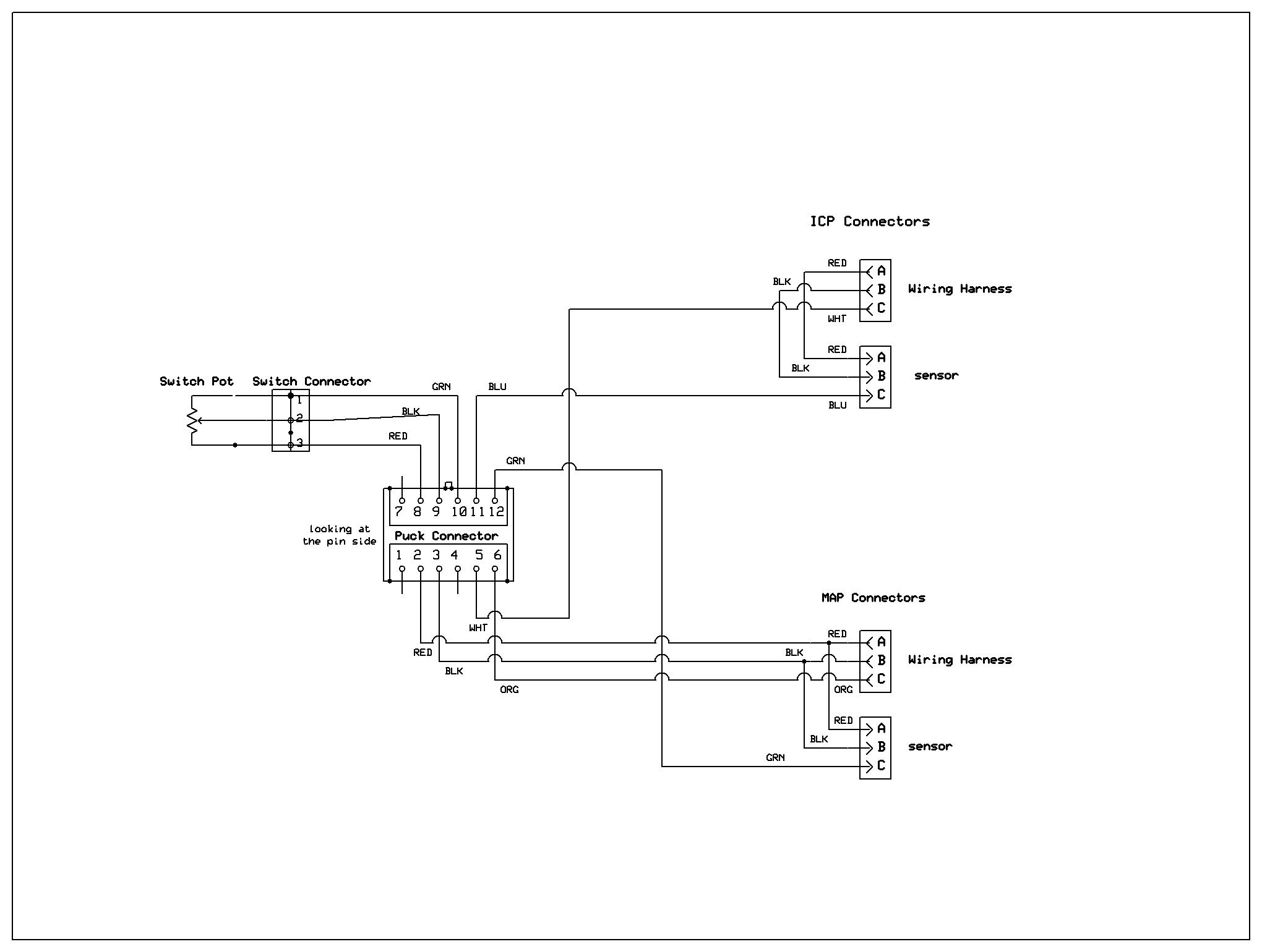

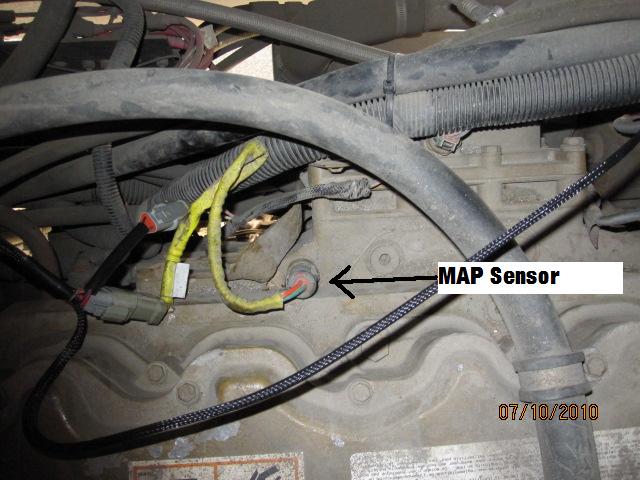

1999 Damon ultrasport 36.5I have done some troubleshooting and I think the problem is in the puck. I'm adding some pics of where I connected the puck and also a schematic of how my harness is wired. Let me know if all is correct of not.

1999 Damon ultrasport 36.5I have done some troubleshooting and I think the problem is in the puck. IThe schematic didn't take so I'm trying again.
