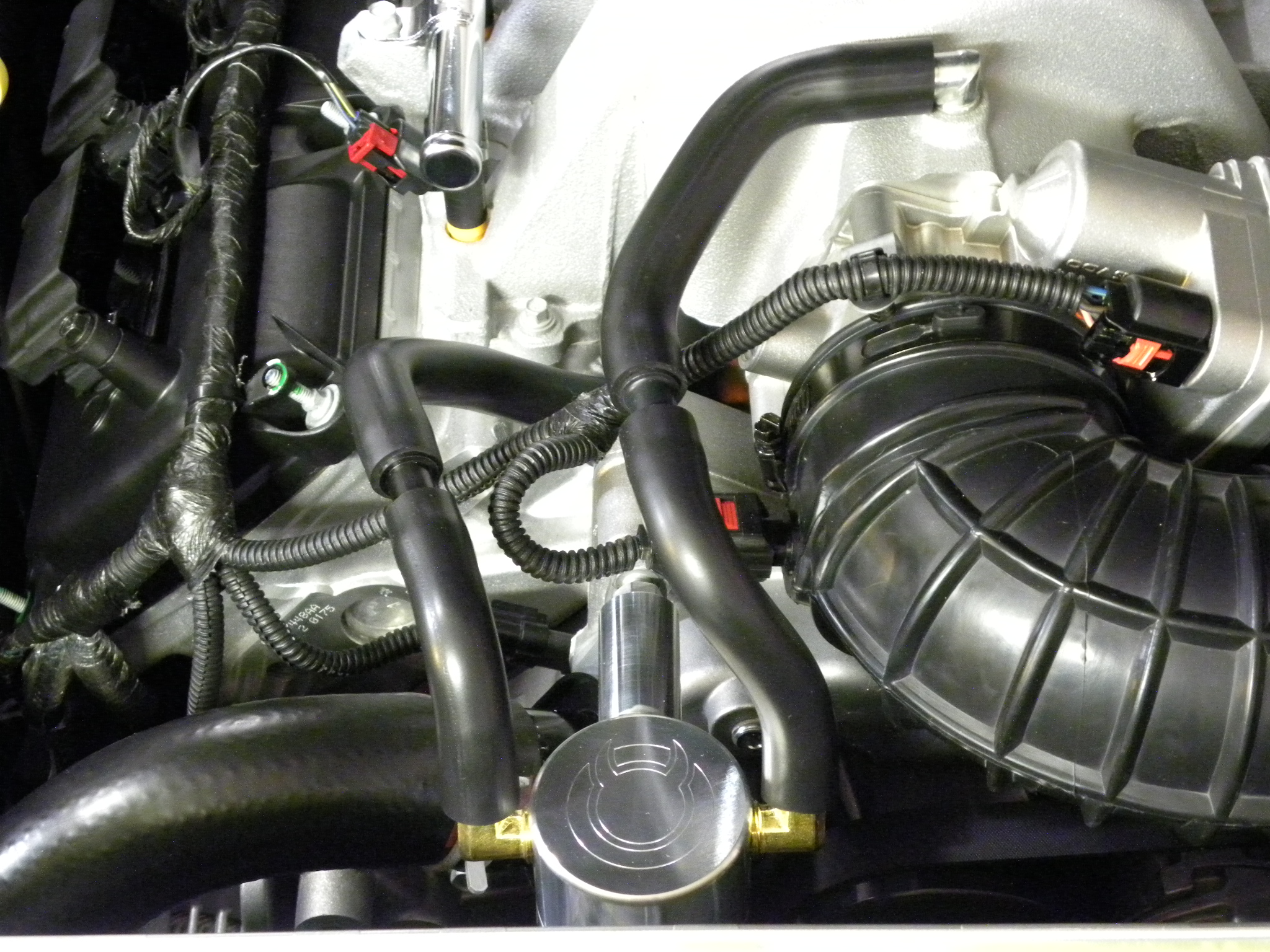

2009 Challenger SRT 6.1 Diablo C1010 (BT) oil catch can installed using "three" 6.1 PCV hoses part # 5037515AA (less then $4.00 each at my Dodge Parts Dealer)
Actually 2 and 1/2 PCV hoses... the only full uncut PCV hose is the one connected to the PCV valve.. The others were cut to place the bends in a almost factory look to the Diablo Can 90 degree barbs. My goal was to make it look like what the factory might do... I used 1/2 Hose connectors to join the hoses to get the length needed.
I just wish the 90 degree Can barbs were BLACK like the product is shown on this sites product info. (and NOT Brass) But, I will find some black fittings one of these days...
If these pictures help ONE person... I will be happy! I could not find pics like this in the week leading up to my purchase .... Good Luck!

Challenger 6.1 Diablo Oil Catch Can w/ factory PCV hoses
- Top Front View
- Diablo5.JPG (1.4 MiB) Viewed 8080 times
- Side View
- Diablo6.JPG (1.48 MiB) Viewed 8080 times

Oh, I forgot to say the CAN works GREAT ! Did not take long for me to see oil in the bottom of the catch can... and the Intake barb "DRY"... where before I always found oil in the lip.
Thanks Diablo Team....
