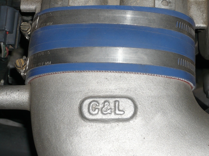

There is no logo on the cold air intake.
I have take 2 pictures :
P1050057 800.JPG (307.36 KiB) Viewed 2644 times
P1050058 800.JPG (278.31 KiB) Viewed 2644 times

It is a C&L cold air kit looks like.It is a good one,but I'm sure it has to be tuned.It could already be tuned by a Diablosport divice.If that is the case, it will work , no problem.If it has a custom tune you my have to take it to a Ford dealership and have it reflashed to stock, then you can reflash with the Trinity.There is a good chance it will recognize the tune and download it as the original backup. The Trinity will work, that is why I have 2 of them. The worst thing that could happen is you might have to have a dealer reflash to stock,then use the Trinity to retune for your CAI. The tune for the C&L CAI is already on the Trinity, along with many more. I really like mine. I am just a satisfied customer,I do not work for Diablosport,but that would be a fab gig.
Any Ford dealership can reflash your Mustang back to stock tune, but I would reflash it again to the C&L CAI tune in the parking lot before you leave.

After putting pictures, I have a look in "Mustangs Unlimited" catalogue and I found the C&L CAI and it is sold without programmer.
