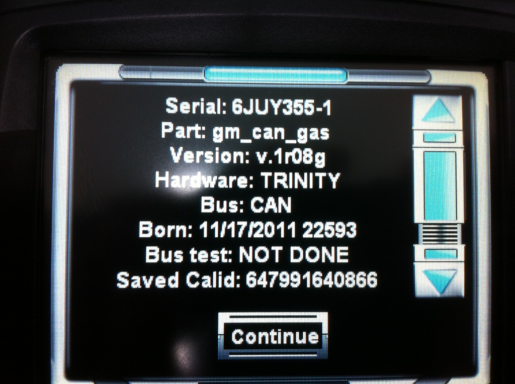

For some reason I'm unable to install the TCM tune from my trinity. It will read it fine but when i go to install the tune it only installs the ECM tune and never gives a option to install the TCM. When I modify the dablo tune it gives me options to adjust the shift pressure and shift points but when I proceed with installing the tune it doesn't  program the tranny at all and the trinity shows that i have the Diablo tune installed and the TCM is still the original backup.
Im using the latest crom file available for download ( v.1r08g ) So what can I do to get this bug fixed? Do I need to post up a copy of my TCM backup for a updated crom file maybe?

sounds like you are on a cal id that is not supported.
if you can please email your original backup for both PCM/ecm and TCM to [email protected]
also if you can please post your current calibration numbers.

Alright heres the orginal backups and I emailed them to you as well.
Lew I did see another update crom in another thread with a guy having a similar problem but I thought I needed to post up my specific backup to be added otherwise I would of tried that update.
