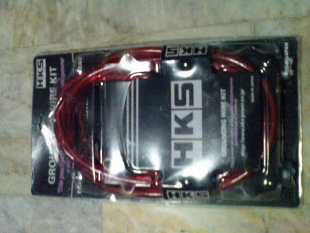

on my truck (06 hemi) and on my friend's (04 rumble bee) we Ran a 4 AWG HKS GROUNDING WIRE KIT from the upper left TB bolt to the ground bolt on the passenger side and zip-tied it all down and that made obvious improvements in throttle response and smooth idling on both trucks ,,,

you have an SRT-8, right? may not get the same improvement, since 6.1 intake is aluminum and conducts electricity. should have much better direct ground than plastic 5.7 intake.Mike_Levy wrote:Real easy. I made one the other night in about 3 minutes out of scrap parts. Used crimp connectors since thats what I had around. No idea if I'll ever use it, or if I need it, but I had nothing better to do.
