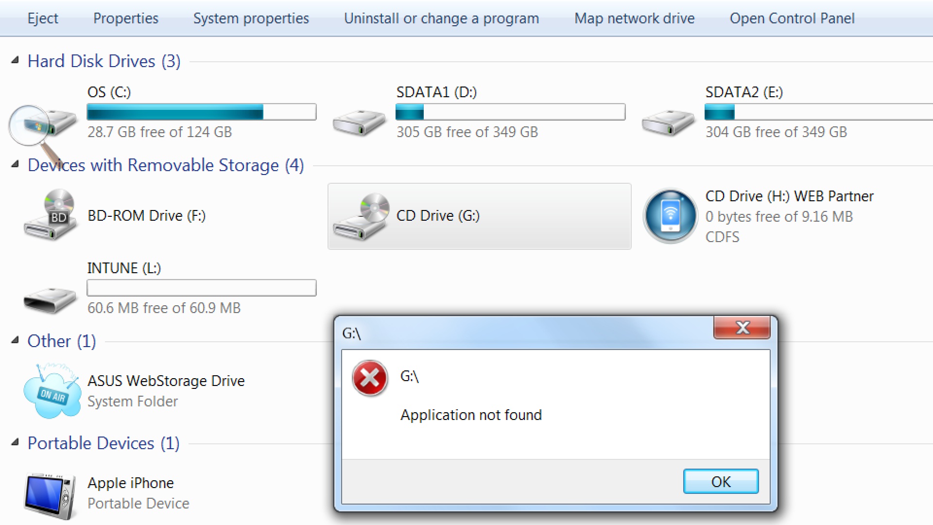

i just finshed from updating my intune software , after installing the update , i can't run intune.exe while its connected via usb , its shows a cd room and a Intune partition , however , the cd room when i press on it it says applicatio cant be found , the Intune partition runs okay and it shows the folders , before the update the intune icon and files was shown now it not , i removed the devise and connect it to the usb the same thing happen , i included a pcture of the roblem when its happnens , can you please help ?

a copy of the problem when it happens

try manually dragging this file ot the intune drive, let it reboot, and it should be fixed...
cdrom-1r01e.itf
(5.26 MiB) Downloaded 153 times

i followed the steps , the icon shows up , when i press the icon to run intune.exe , it freeze , any idea ?
Posts: 58771
what freezes?
does it launch?

no it was not , but now all are working fine , thanks for your help .
