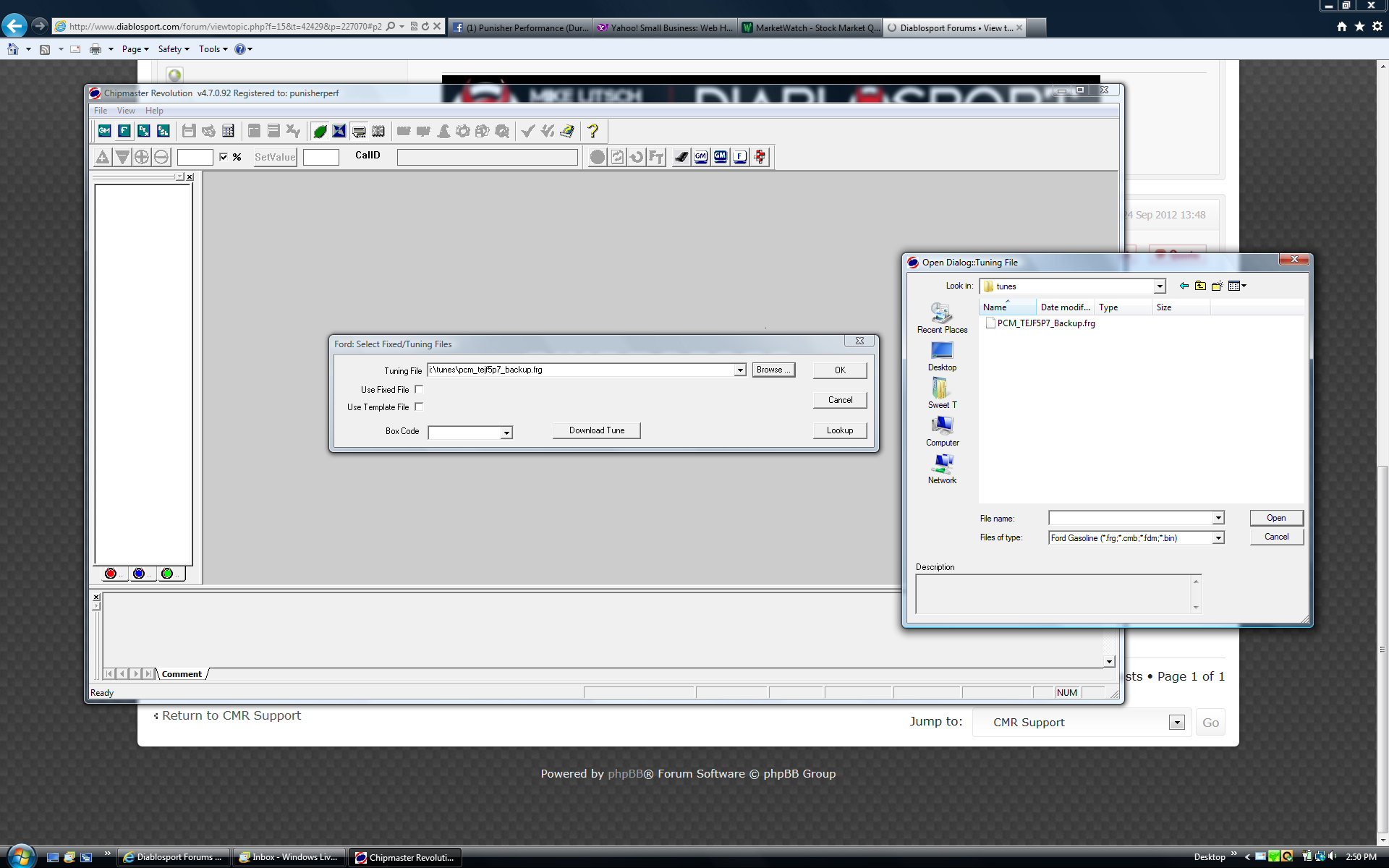

Does this look like it's a Power Stroke tune? Or can you tell me which stock tune this is? Thanks!
I found a few stock files in the ORI folder, thanks for the help!
- Power Stroke Tune.jpg (526.73 KiB) Viewed 6952 times

thats a 7.3 tune, yes...
