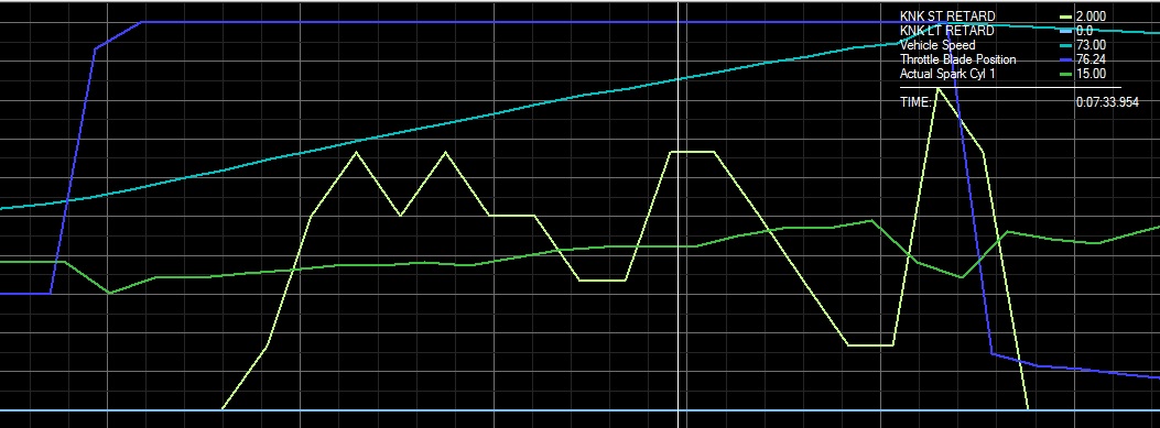

You need to include the Short Term and Long Term Knock Retard PIDs when you log.

done :D

sharkcohen
Posts: 127
Joined: Tue Feb 01, 2011 9:14 pm
Re: orginal backup its better than tuned
Post by sharkcohen »
Yah, you're getting some knock. That's going to hurt performance. Have you tried adding 5% fuel?
