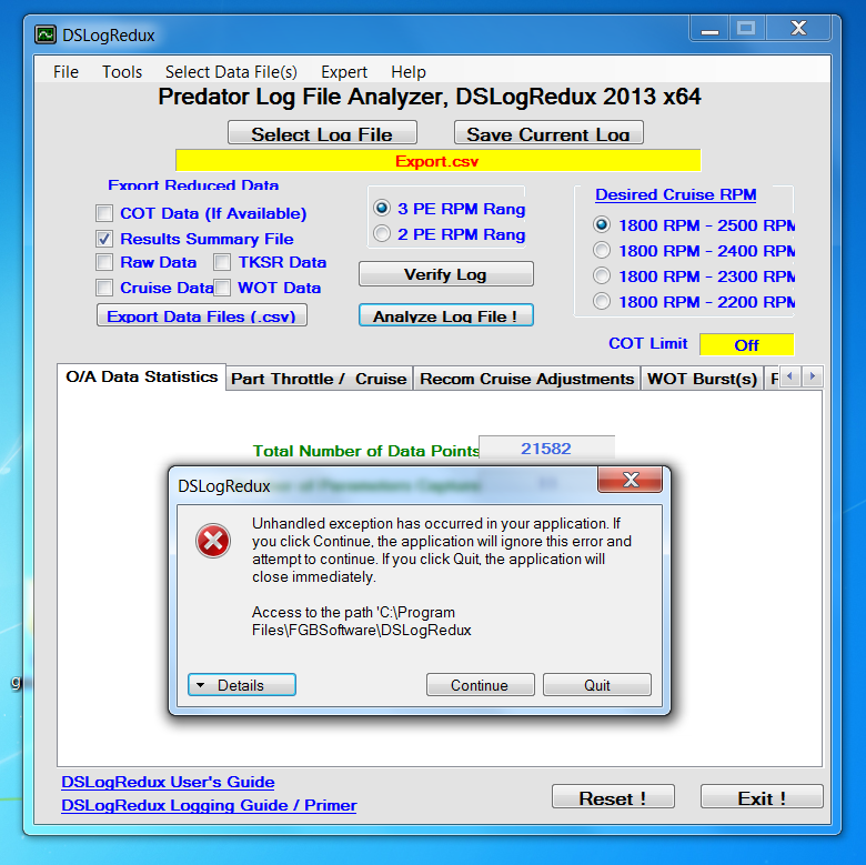

I followed the directions to make a log and saved as a csv file....I can see the data in the dataviewer but get an unhandled exception error when opening it up in the dslogredux app. What other way can I figure out what parameters to change to make my Yukon 5.3 to quick spark knocking with I have the 87 octane tune installed? Any suggestions? thanks!!

- error message
- error.png (183.51 KiB) Viewed 2733 times

it's a user permissions issue on your PC... it's not getting access to that path...
you need to make sure your windows user account is an Administrator account...
and you need to disable the UAC crap for your user account.. the User Access Control... disable that, reboot your PC, and you'll be good to go...

Good call...it was the UAC...gettin it dialed in now!! Thanks a bunch!!!!
