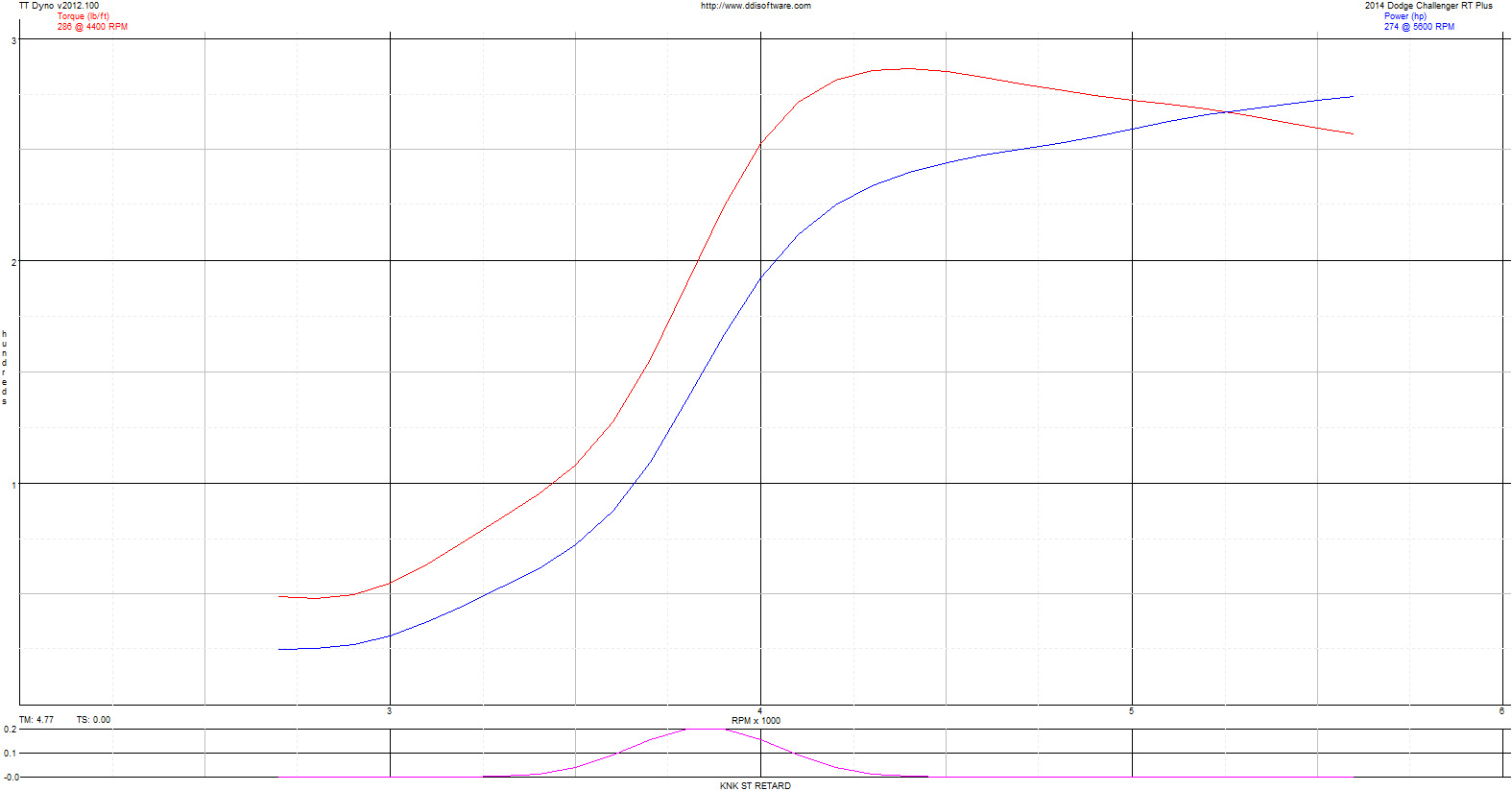

Wanted to share this...
2014 Challenger R/T
Mods:
Catback Flowmaster
93 Octane custom tune.
I uploaded the CVS file from my DiabloSport Log and uploaded it to TT Dyno software and here are the results.
274 HP at 5600 RPM
286 Torque at 4400 RPM
I noticed some knock at WOT
Not satisfied. I was hoping for more..
I will be re-loading a custom tune 91 Octane and compare the results.

2014 Challenger R/T
2014 Challenger R/T
TT Dyno.jpg (150.93 KiB) Viewed 20273 times

that TT Dyno software is not really accurate haha. .I know what you're talking about, I tried it out years ago...
you're better off using Torque Pro app for your cell phone....
Re: Challenger R/T using TT Dyno Software
TTDyno is about 5% below a chassis dyno. I've used it multiple times and have actually dynoed the vehicles.
I still hate Torque. Its interface is horrible. It doesn't log properly. And its Android only, so I gotta drag out the Nexus. 3 strikes, they're out.

This is good news! So this means that my HP will be higher?
If you got the weight and all the other inputs correct.

You're right and thanks for reminding me... I guesstimated on the weight.

What software or device would you recommend? I checked out elm 327 obd2 and it looks fascinating.
Is there other device you would recommend?
I use 2 different ELM327 modules. A WiFi one for my iPhone that works with Engine Link, and a Bluetooth one for my Nexus (or any Android device) with Torque Pro. Truthfully, I prefer using a Diablo device over either one. Its just easier to work with for me. The Dashhawk was my choice in the past, but since MSD stopped supporting it, its died out. DashDAQ is nice, but stupidly expensive.

yes you hp and tq should be way higher. I have a 2012 dodge charger with 24's on it and I'm getting 373 hp and 349 tq with just diablo and k$N Cai and magna flow pipes.
