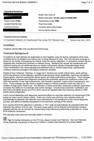

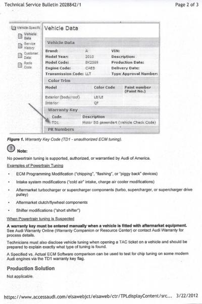

Re: Is this legal in any way?
Lets see if these work. I think they may be too small. This is Audis version of it.

Post by monster71 »
Wow. Really. CAI is considered as "tuning" and could be cause for no warranty work, as is a short shifter. And would be tagged TD1. Guess ima have to buy a Smart car. Bet they will say my 270 lb body frame voids the warranty. :)
