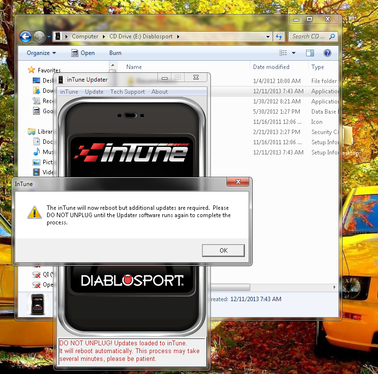

Hmm, when i reboot the tool it closes the app then I launch the intune app again and it says this:
intune D.png (605.66 KiB) Viewed 9129 times
I hit ok then it sits at this screen indefinitely :
intune Diablo sport.png (540.17 KiB) Viewed 9129 times

Mine does the exact same.... have not updated it in quite some time. Gets to the last image shown above saying DO NOT UNPLUG loading etc..... just stays there indefintley and is somewhat hot while it is there. I've let it sit like that for several hours a couple of times now. Unplug it, plug it in again and it goes through the same process and stick in the same place. It does check for updates again but does not download anything, I'm assuming since it has already downloaded the updates which are sitting on the removable drive part (only a couple of mb of free space left - the group_update.itfg and a few .pz files are on there). I've tried not letting it autorun and right clicking run as admin, etc to no avail. It seems that the device simply cannot actually install the update files. Also tried removing the tune on my truck and putting it back to stock to make sure the device is clear. No difference.
For the price point on these (realistically it would have probably cost about $10 more to manufacture them with a faster processor and USB controller) I'd have paid ten or twenty bucks more for it to perform like a $200+ device.
Going to go give it a try on another computer. Maybe my main work machine is too fast (this is a design workstation, Dell Precision T7600 with dual hex-core Xeon, 96gb ram, quad SSD's, running x64 Windows 7 Pro and a bunch of design applications) or some of the server class components are freaking it out. Will try the shipping computer in a few which is a basic x32 Windows 7 pro desktop machine.
Edit to add- figured I've just go at it and try and figure things out on my own. I copied all of the .pz files to my computer (just in case I needed them) then deleted them from the device. This time it would update but then would error about could not update current version with version something...
From the forums here I manually downloaded intune-1ro3y.itf and 1ro4d to my computer. After the last failed update the only file still in the root of the intune was the info.xml file. I just copied the 1r03y file to it. The device automatically started loading the file, copied, verified and rebooted. It took the file and upgraded itself the 1r03y release no problem without using the intune updater program. Then I copied the 1r04d file to the intune (this is all to the main intune drive, not the cdrom drive). The device again automatically and immediately showed on its screen that it was copying then verifying the file. Then it automatically rebooted itself and was good to go again. This time I did do the autoplay on the updated program (cdrom) and that program did its thing and the updated program then reported the device is now up to date.
My suggestion would be for Diablosport to code the updater program to let the webserver know what the current version is so that the updater will first download the correct next required version. What it seems to do is just sees a newer version and tries to install it even though there are possibly intermediate versions that MUST be installed BEFORE the newest version can be loaded.
