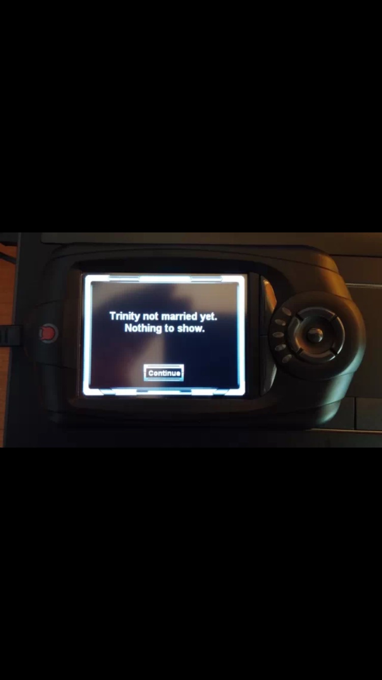

Hello, I'm in the process of purchasing a second hand t1000, I know it's been talked about plenty of times and I have read some of the posts. The seller sent me pictures of the device and it pops up a screen that says "trinity not married yet, nothing to show" (pic attached) I just sent another message asking if the VIN was still there or not. If the vin is still there will I have to call in and have a forced unlock done on it for a fee, or will I be fine after I plug it into my car as long as it isn't showing married? Thanks in advance.

unfortunately with trinity it can be more involved, what happens if they go to options/troubleshooting, and select the blank line at the bottom?

mikel wrote:unfortunately with trinity it can be more involved, what happens if they go to options/troubleshooting, and select the blank line at the bottom?
What should I be looking for? I will ask the seller.

So let me ask this, plan for the worst case scenario... It is still preloaded with a tune and a VIN.. I have to call and pay a fee for a password?

yes, it would cost you $179 to get the trinity unlocked/reset...

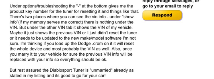

Thanks Monte, this is what the seller sent me. Now, how do I go about switching it to dodge when I receieve it?

Re: Buying a used t-1000
if it truly shows a password when you select the blank line, its unlocked.
