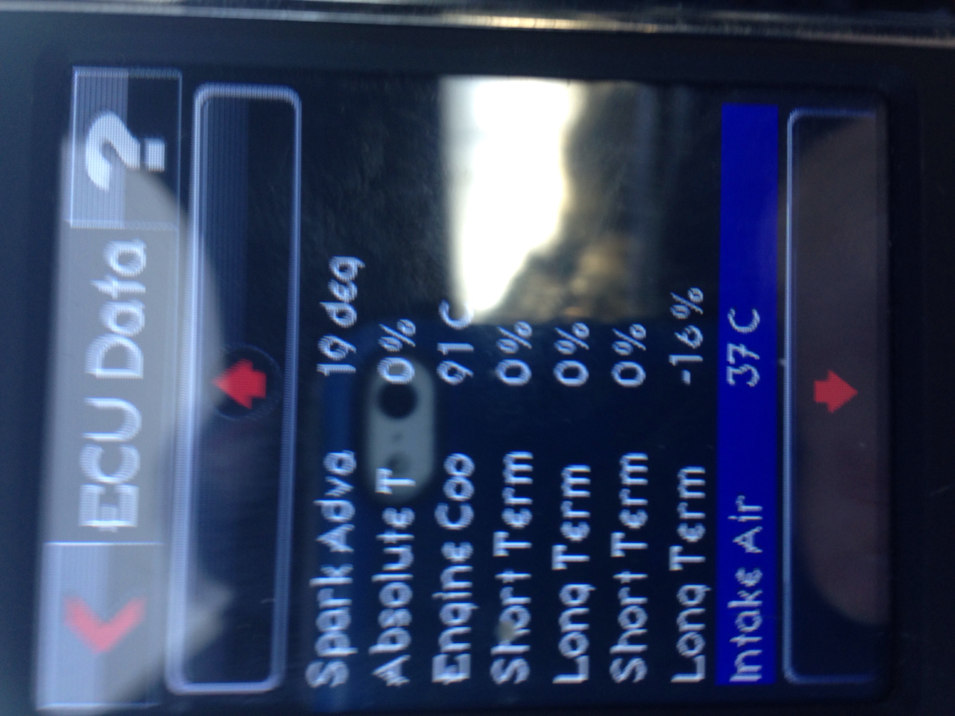

How does these fuel trims look. This at idel after fully warmed up. Drove it about 5 miles. And 1% smaller on the injector slope. One of the LT fuel trims is -16. Weird....
