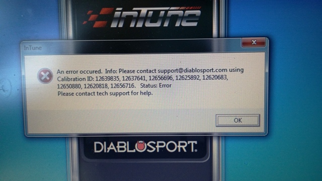

Hey guys, I received a replacement Intune and I'm getting these error messages. Can anyone help a brohter out?
Thanks!

Re: Replacement Intune
post the file here please.

save this to the intune drive and the tool will import it then go to the vehicle and load the update to set the pcm back to stock.hebe_jebe wrote:Ive attached all of the files I can find on the Intune drive.

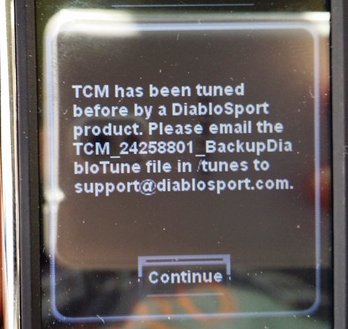

Ok, can someone tell me what tune I have on my truck at this point and how do we go about getting the TCM straightened out?
sh*^, sorry, i started this about 8 hours ago and got distracted.
Gimme 2 minutes
Gimme 2 minutes
- Posts: 58677
OK, load this just like the pcm file, and then the tcm will be back to stock and you may load any tunes you choose.
