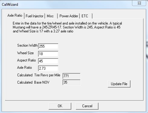

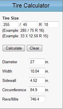

I also was able to look at the CMR DEMO software and noticed the tire size calculation is WRONG...
For a 255/45/18 tire/wheel the CMR software shows 771 revolutions per mile, BUT every tire shop site with a size calculator shows it to be 746.4... that's no small difference...
Seems like if that simple math escapes the software folks there are likely other issues as well...

- Normal tire calc (746.4 RPM)
- TireSizeCalc.JPG (24.62 KiB) Viewed 29405 times
- CMR Tire calc (771 RPM)
- BadTireCalc.JPG (36.48 KiB) Viewed 29405 times

The question in my mind still remains regarding the tire size and revs per mile though.
When adjusting parameters the inTune device wants revs per mile for the tire size installed.
For my 255/45/18s am I to use the 746 as all tire shops show or should I be using the 771 that was shown in the CMR software?
