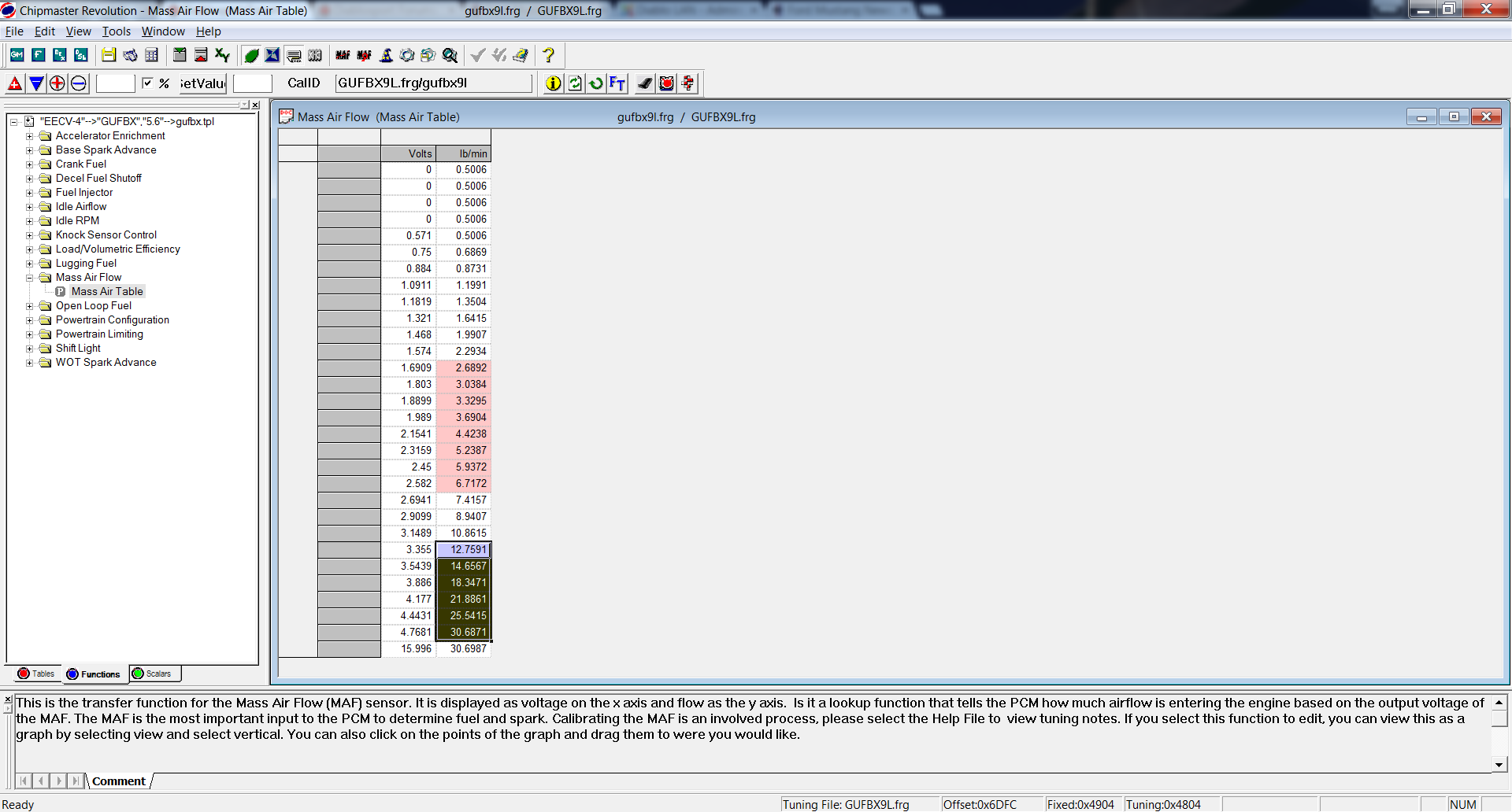

Hello, i have tried several of my versions of CMR and i cannot get the a9l tune to allow me to change the MAF voltage table.. when i change a number it goes all haywire and makes its something like a 9.4 or what have you... the maf im working with uses voltage all the way down to .3v when it idles.. any ideas? thanks Nick

I am trying to change the lower end of the voltage side of the chart (although any change to any of the voltage set points in the voltage column makes it go haywire) .... say i wanted to change the last voltage set point there from the .57 to .34 as a sake of reference... when i type the .34 in, and press enter to make the cell change, it changes the cell, but not to .34 as comanded, it changes it to like 12v, or 8v.... it goes completely weird... it doesnt do this with any other ecu strategy...
