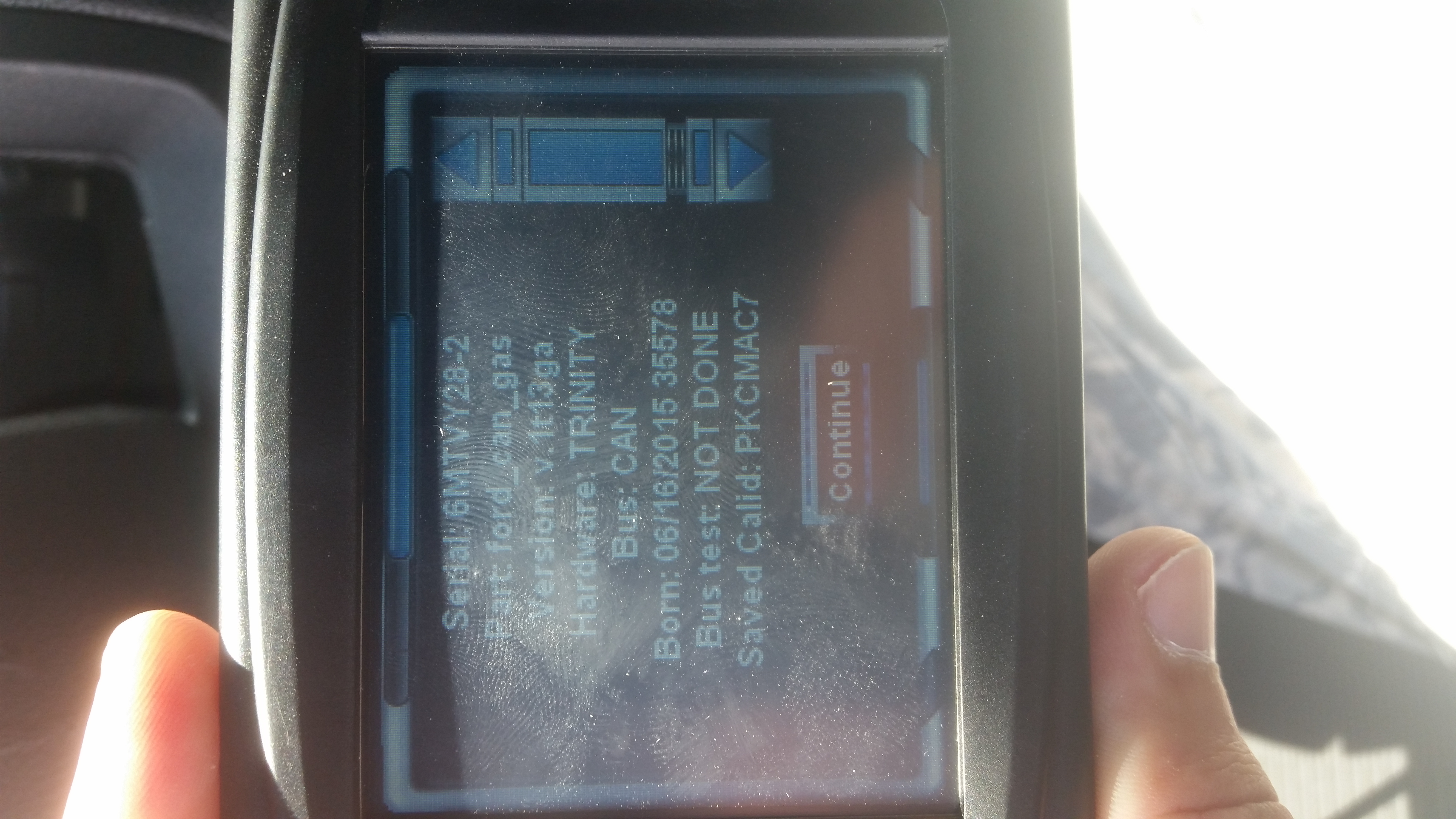

kellyfj10 wrote:The version is v.1r13f. I loaded the premium tune and had the same result, no throttle response after a couple of minutes. Then when I tried to load the original tune back it said that the tuner was used to load a 2004-2014 f150 and it wouldn't let me go any further. After several attempts it let me load the factory tune back.
Mike, I think I have the latest tune. What do you advise?

did you experienced the same power loss ? . did it get fixed ? I uploaded the file trinity_ford_can_gas-1r13f_update.crom with speed limit off performance 93

Please load this update then reload the tunes, it should be corrected.
trinity_ford_can_gas-1t13ga_update.crom

I put the updated tune in, drove it lastnight and it was fine. Got in it this morning and driver it for 5 minutes it was fine, went to get on the highway and lost all throttle. I was using the premium tune. Also, when I installed the premium tune, I didn't notice a difference in the performace. If anything, I thought it was a little more sluggish then the normal tune.
