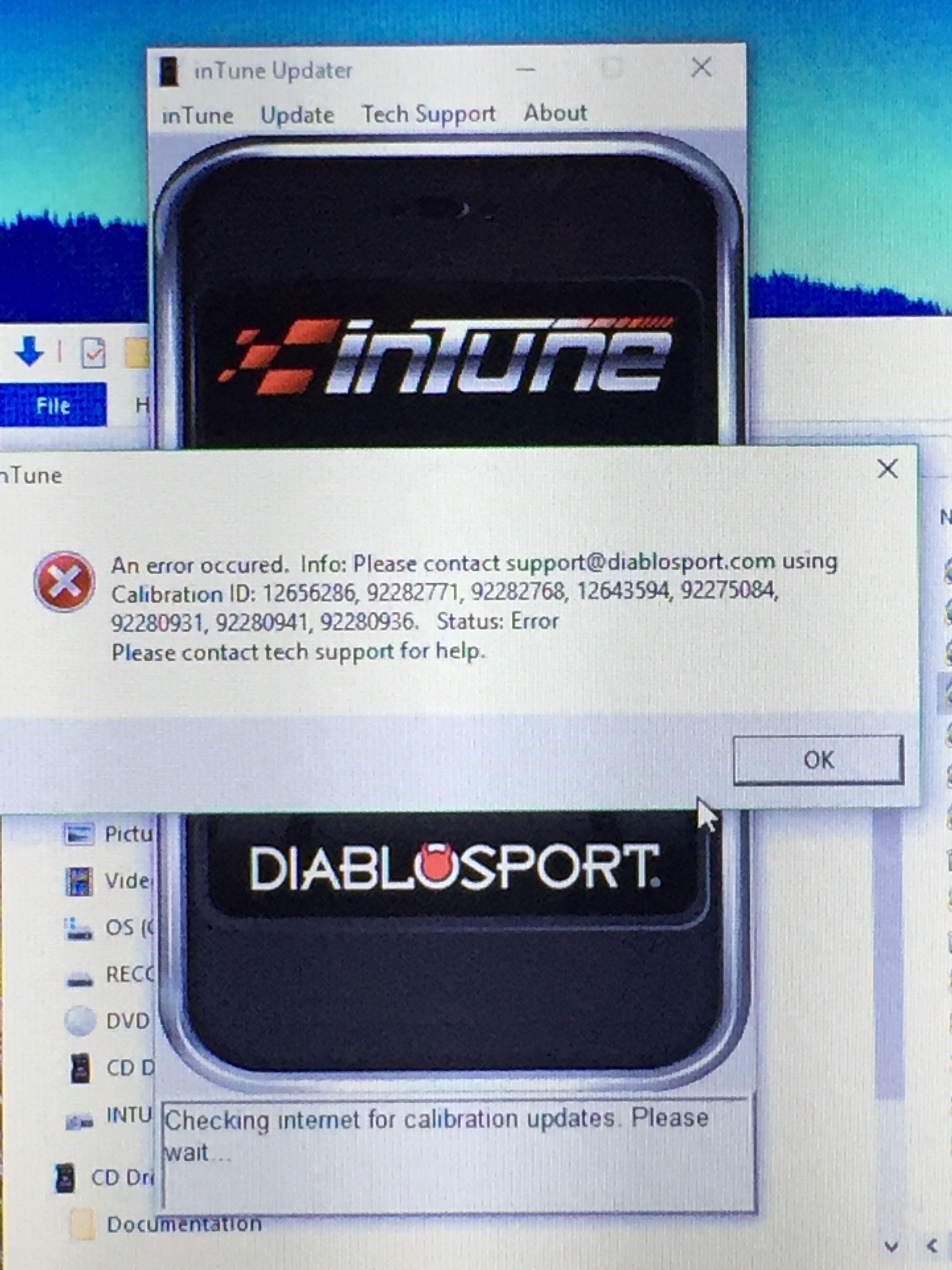

Keep receiving the same error message now every time I plug in the intune to the laptop. Worked fine for the first month and then just?????
Please see the attached picture for the exact error message.

any files in the tunes folder?
post them here please.

shmigelz wrote:here are the files in the tunes folder.
save this to the intune drive and let the tool import it then go to the vehicle and click tune vehicle/write vehicle and let it load the update to set the pcm back to stock.
