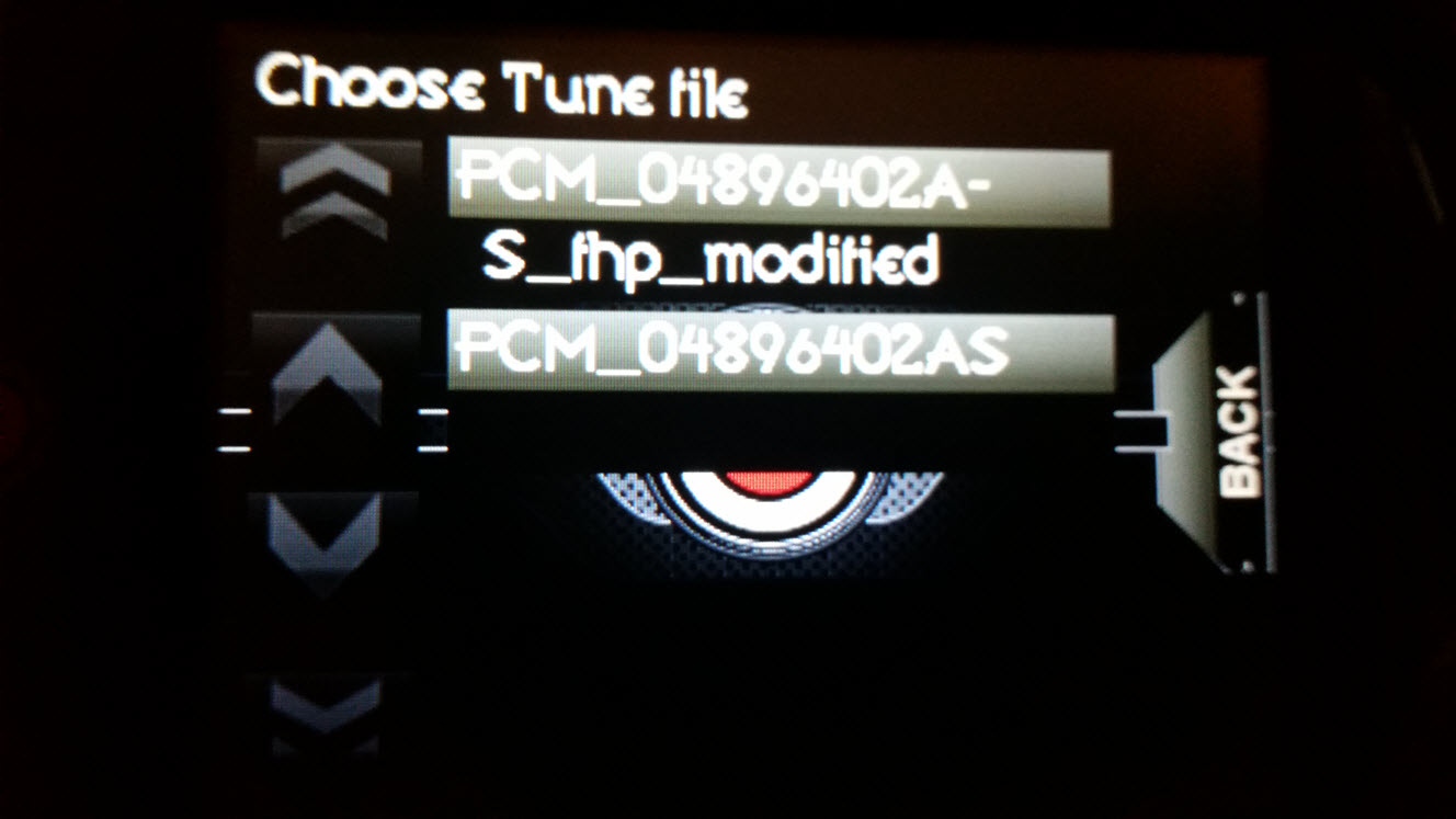

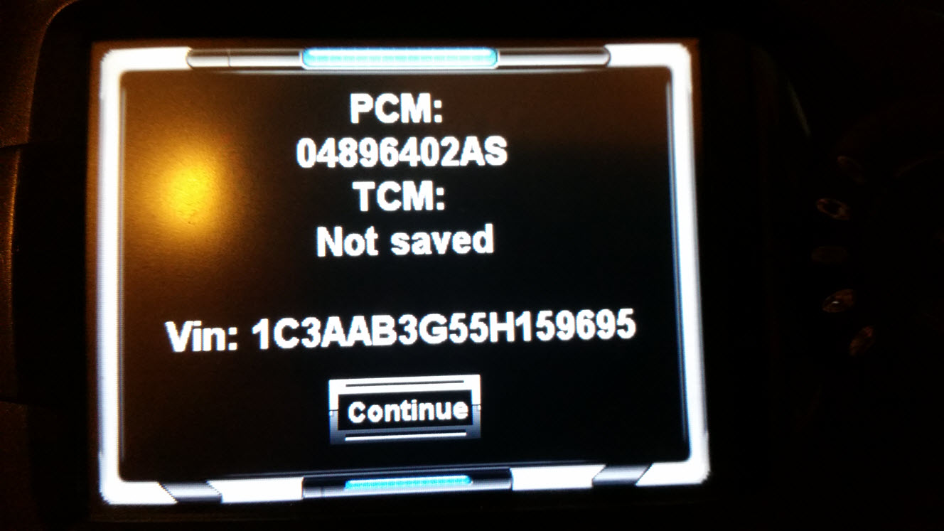

Married or Unmarried, i have a modified stock tune.
Can anybody tell me !
Thanks!!

- Posts: 58698
Re: Married or Unmarried? So confused!
that tool is married.
