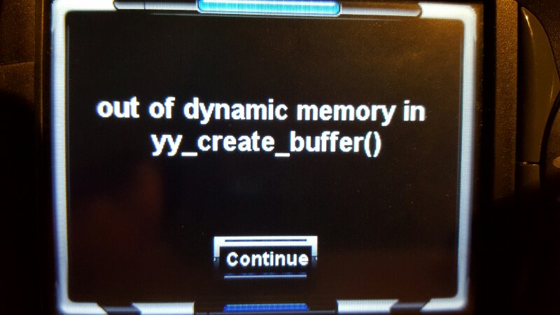

Mike, I loaded the update and attempted to tune the Durango but after I hit agree on the disclaimer it freezes. Also got an out of memory message when selecting show information. I'll post a pic of that.
- JPEG_20160121_153605_1132445769.jpg (54.87 KiB) Viewed 4654 times

Re: 2013 Durango 3.6L failed to save original backup
sorry, there was an issue there, new one attached here.speedy wrote:Mike, I loaded the update and attempted to tune the Durango but after I hit agree on the disclaimer it freezes. Also got an out of memory message when selecting show information. I'll post a pic of that.
