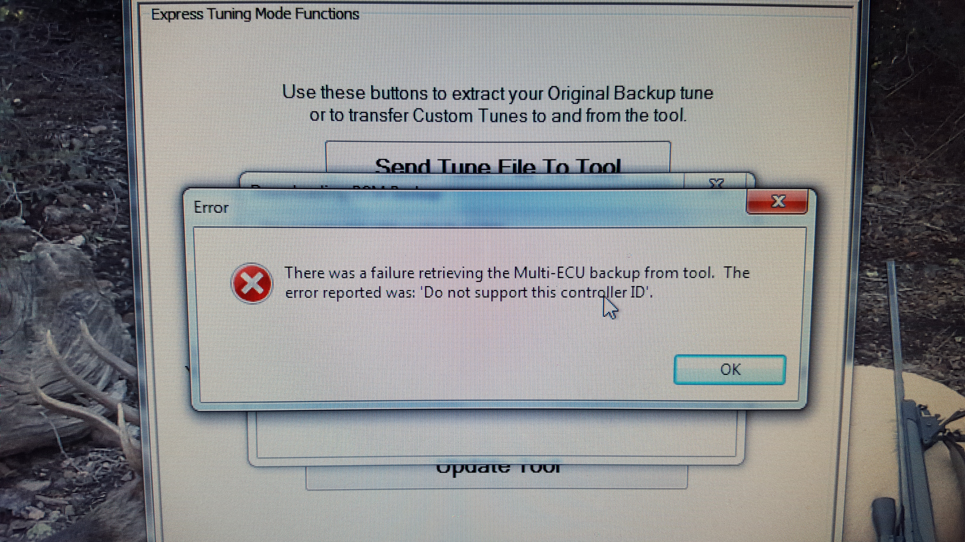

Yup, I tired that 3 times to be exact even with the canned tunes you go through the loading the 87 perf tune, and perf trans tune, the unit appears to write, after the key is cycled as the unit suggest it shows that its written, the trinity then reboots, you go to last tune written and only PCM shows, no TCM and I get the same error box that others have got.

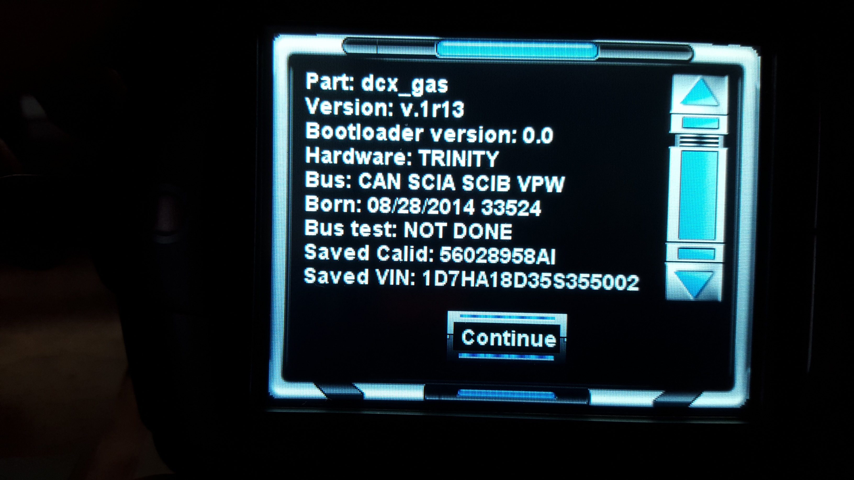

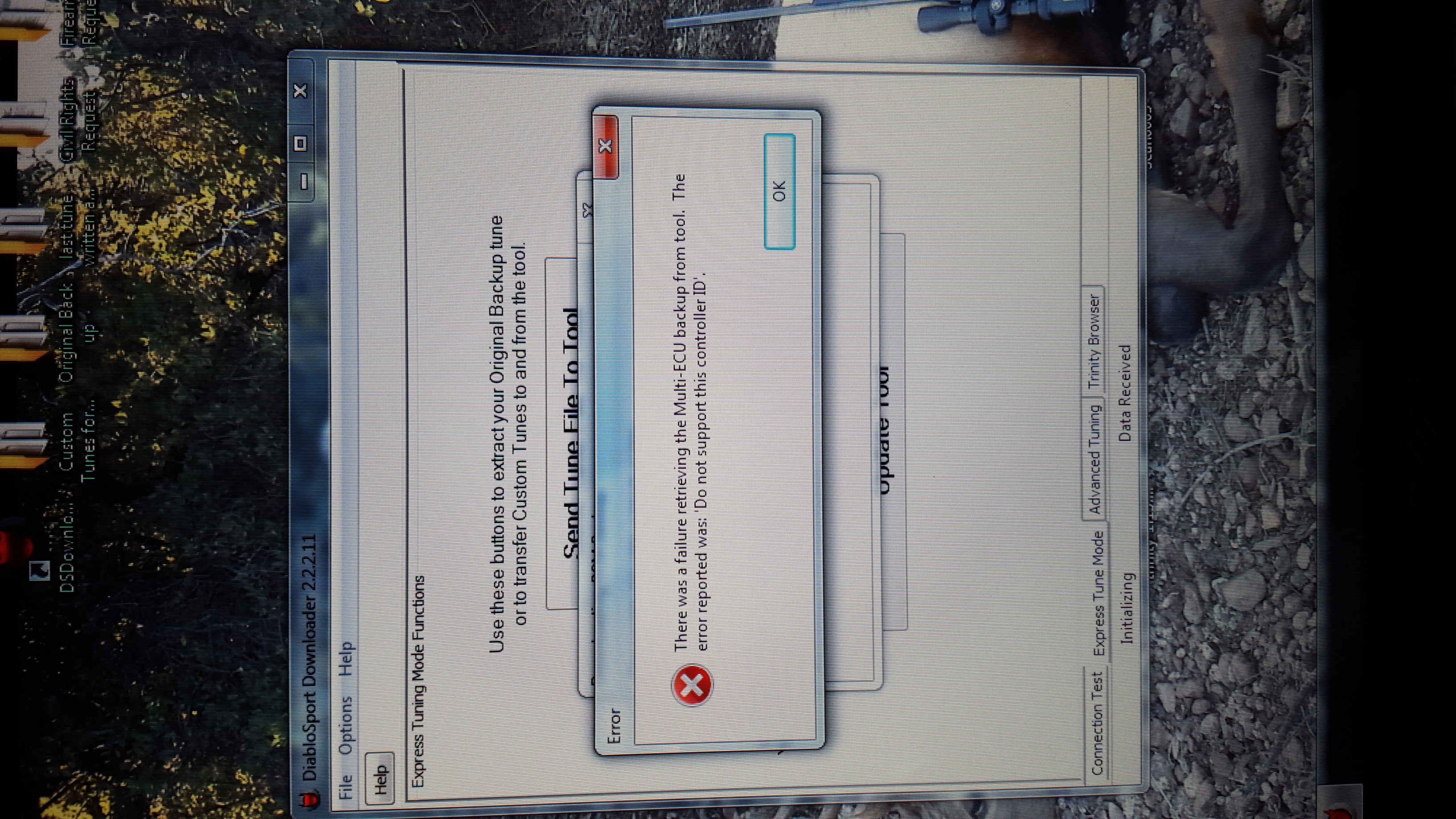

This box just as every other person who has an 04-06 ram hemi...the trinity does not read nor remember the TCM backup
Trying to pull original backup

No TCM backup
No TCM backup

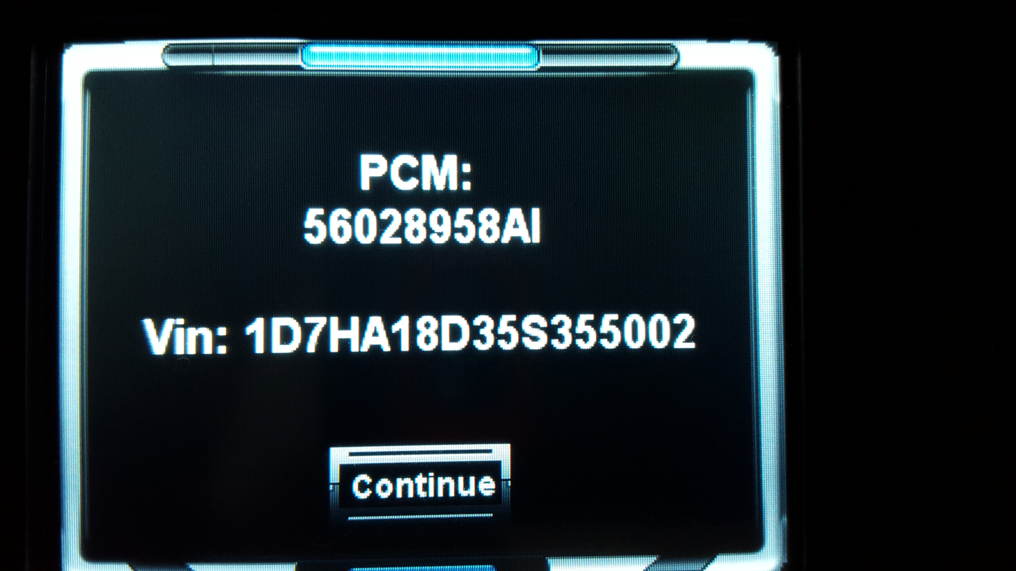

It remembers the pcm back up, save it then it goes to look for TCM thats when u get the error box
It remembers the PCM back up

This is all the info that the trinity shows
It only saved the PCM
