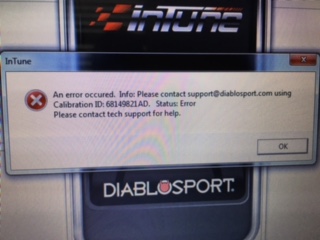

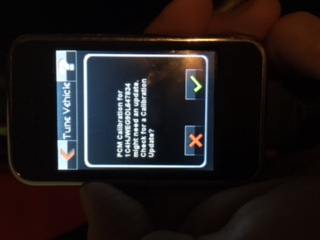

I cant seem to write to my Jeep. I used it on my Challenger for years and I unmarried my Challenger with zero issues but now I cant do anything to my Jeep at all and its rather frustrating. I have really backed Diablo for so long but these issues are making me wonder. I am hoping to get some help quick... Now I cant even check for updates. Please help.

<?xml version="1.0"?>
-<tool_info>
<main svn="8521" sw_rev="1r04i" full_version="InTune-1r04i 08/03/2015 01:32:36 PM"/>
<registration status="1" sn="J22BB6E-4"/>
<cal_id CM1="05150808ACjd4p0" PCM="68149821AD"/>
<restore bc="0" vin="1C4HJWEG9DL647834" id="0"/>
<system_db vin="1r01g" dtc="1r01a" info="1r01b"/>
<db pid="1r01b" tune="1r01f" mfr="DCX"/>
<db pid="1r01b" tune="1r02g" mfr="FORD"/>
<db pid="1r01a" tune="1r02s" mfr="GM"/>
<license tuned="0" avail="1"/>
<unsupported vin="1C4HJWEG9DL647834" oem="DCX" calid="68149821AD"/>
<updates count="5"/>
<oem tool_oem="DIABLO"/>

Re: PCM Calibration for my Jeep
Your VIN is showing that you have a 2013 JK, is that correct? If so the i1000 will not work for that vehicle. They support up to 2010. You will need either the i2010 or the i1000 DCX.
