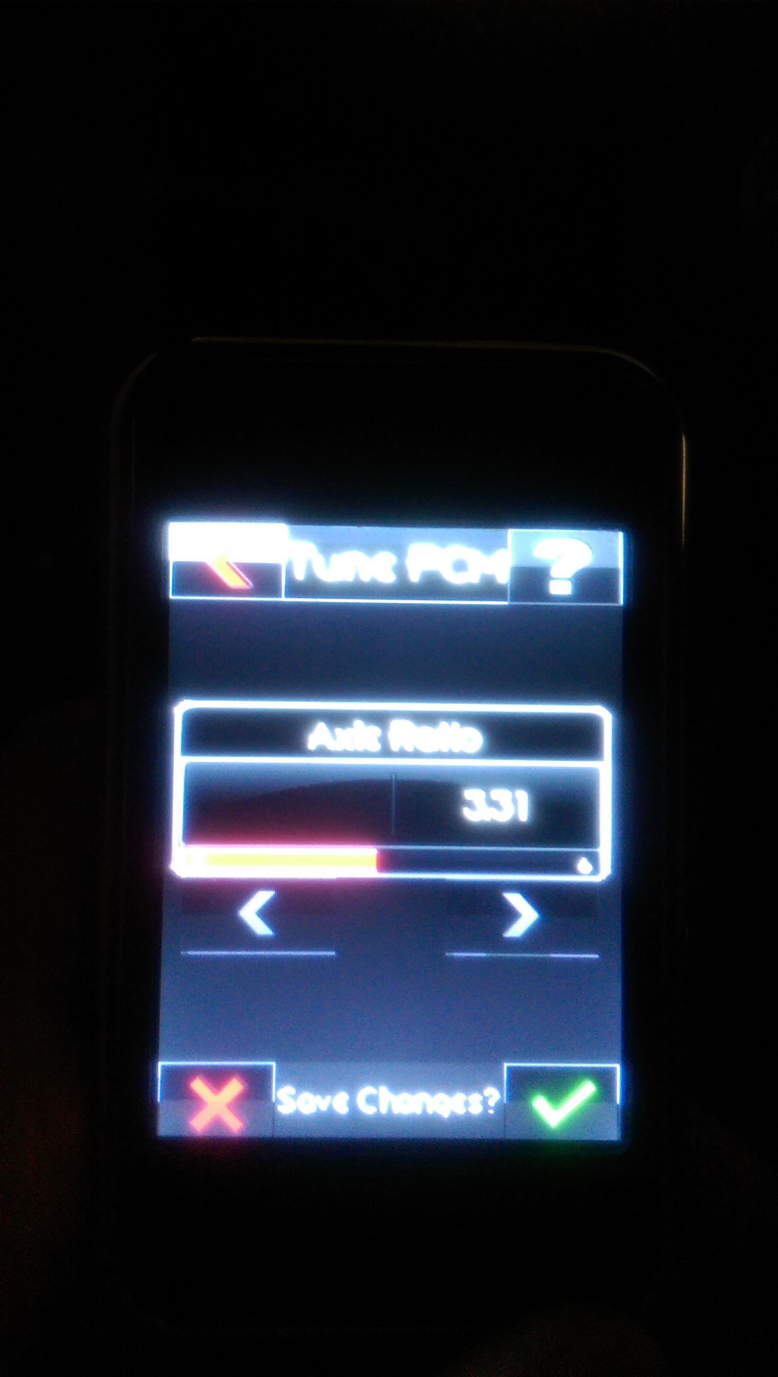

Update:
Today I used the "tire height" adjustable parameter to try to adjust my speedometer. I set it to 26", which is what I physically measured on the car. The speedometer shows only a third (or 1/pi?) of my actual speed as measured by GPS. I confirmed again that the correct gear ratio of 3:31 was in the tuner, which it was. Mike, you'd asked earlier if I'd entered the tire circumference in your previous reply. I cannot see anywhere to enter circumference, and also, with the tire height scale ending at 57" at the upper end, I wouldn't be able to put in the actual circumference anyway.
In summary:
1. The tune I previously uploaded is only off by a bit (130 km/h at actual 120 km/h).
2. When using the tire sidewall calculator for speedometer correction, the shown speed is only about a third of my actual speed.
3. When using the tire height for speedometer correction, the shown speed is only about a third of my actual speed.
4. The old tire revolutions per mile adjustment feature worked perfectly, but this is no longer available. If you were to bring this back I'm sure you'd have some appreciative customers.
Apologies for the quality of the attached pictures.
In summary:
