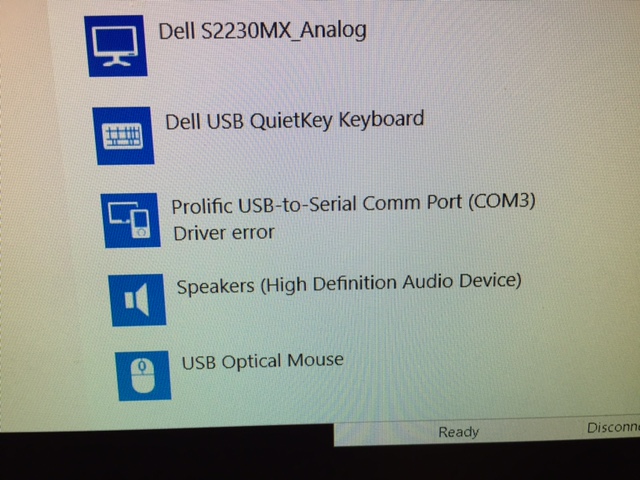

Re: 7000 & 8000 Predators
I did it keeps installing it on com3 but is says driver error when I go look at it in settings
Here is what I am seeing
- IMG_2565 (1).JPG (112.38 KiB) Viewed 7802 times
- Posts: 58674
what is the error in the device manager?
code 10?
code 10?
My DSDL only gives me com1 as an option. My usb to serial is very old I read on prolifics web site something about a newer chip? Any suggestions would help I have a customer who would like to pick up this predator today.
Yes it is This device cannot start (Code 10)
So....just so the thread is warped up. After all the work by the Diablosport team with nothing fixing the problem, I finally went to Best Buy and picked up a new cable and it worked the first try. Same cable I have been using for years but now its in the garbage. Thanks for all the help, sorry to use so much of your time.
