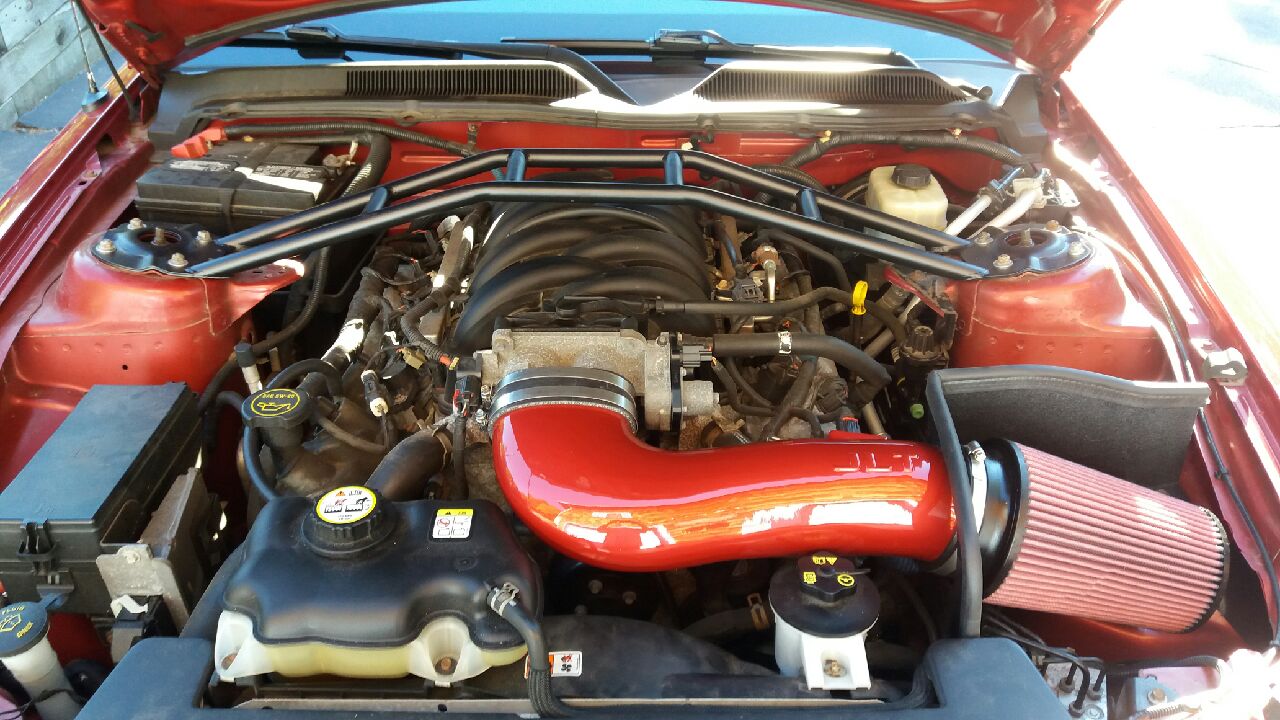

Hi,
I updated my Predator 7140 to V. 9r09
Which tune would I use for the JLT Series 3 CAI?
Thank you,
Frank

Hi,
Attached is the original backup and last tune written.
Thank you,
Frank

here you go. i made some VCT changes for you too. should run harder up top
FBNE0G5_customJLT.frg
(960.14 KiB) Downloaded 416 times

Post by FrankBlack »
I used to tell people that this car "screws", now I tell them that it's on steroids!
This car is really smooth shifting through the gears. It reaches the top of the RPM limit so much faster than it used to.
Sounds incredible, totally different than before. Like a totally different vehicle.
My son is really going to regret selling this to me now :D Wooooooooooooooooooo!
Thank you again for your help!!!
