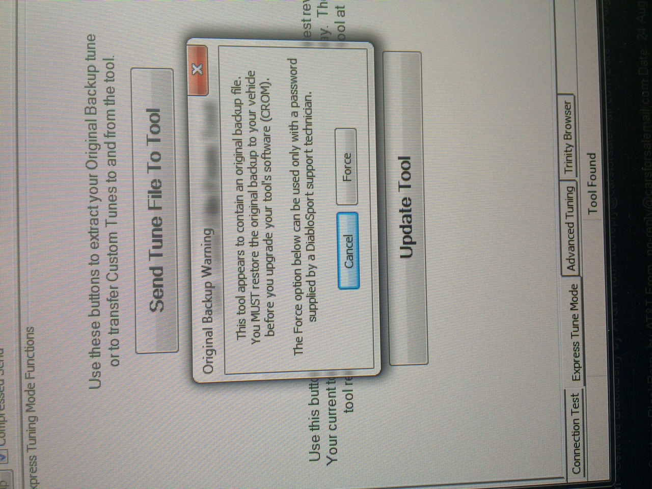

I HAVE DONE THAT! it WILL NOT update because it has my stock tune stored in the unit. but to make it worse this morning when I plugged it into my computer the LED's light up and stay on but it will not boot and the screen is just black

did you see the picture I posted Mikel?

Looks like i am having a similar situation. Did you get it resolved? I am getting the same message as the pic you posted....
