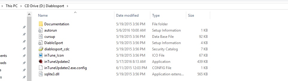

Everything looks normal to me. I deleted the group update file, unplugged and replugged it in, tried again, and still got the same issue. The original updater worked without an issue and now doing the Updater2 I'm getting the error. Nothing is in the Logs, Tunes, or Runtime folders

- Posts: 58807
Re: Error when updating - IO operation will not work
how much space do you see as available on the intune drive?
With that file on there it shows there is only 88.0 KB free, with 60.8 MB used. When I delete the file the free space goes up to 23.8 MB free, with 37.0 MB used.
All of the folders are empty with 0 KB on them, the info.xml file is 2 KB

- Posts: 58807
can you look for hidden files on the intune drive?
You are a great problem solver. I found a bunch of hidden files that I don't see on any of my other intunes. I deleted them (hopefully that's what you were going to tell me to do) and the updater is running like normal now. Thanks a lot Mike!
