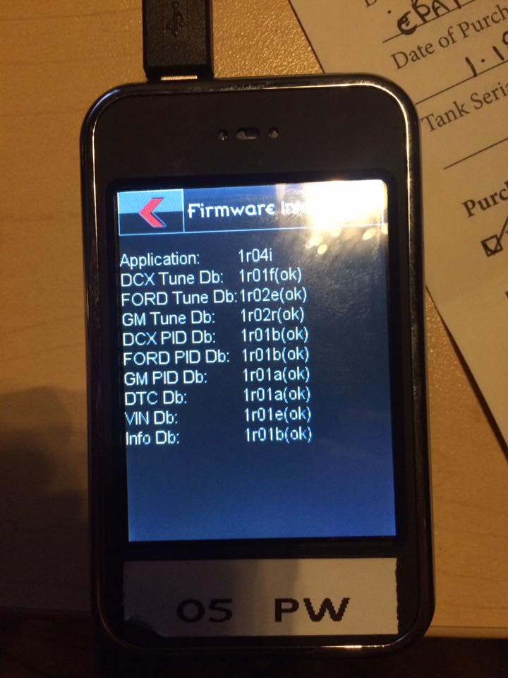

I decided to change some of my settings on my 2005 Dodge Ram. When I hooked up my intune it is telling me that my truck has already been programmed with an intune and asks me to remove it and hook it up to a computer. I did this and thru the installed program nothing happened. Is there an update I am missing? and why would this be happening if this is the one I used to program it and I have not messed with it in a couple years either upgrading the firmware in the unit or updating the settings in my truck? Can someone please help me?

Here is everything I can gather off of the tool and my laptop.

Here is the data I can get to.

Here is the data requested

the tool shows to be married to the device, has the vehicle been updated by a dealer?

no it has not been to a dealer in years and has not had any updates. How do we fix this issue?
Posts: 58807
Re: HELP: intune no longer works with my vehicle?
give us a call and we can reset the tool.
