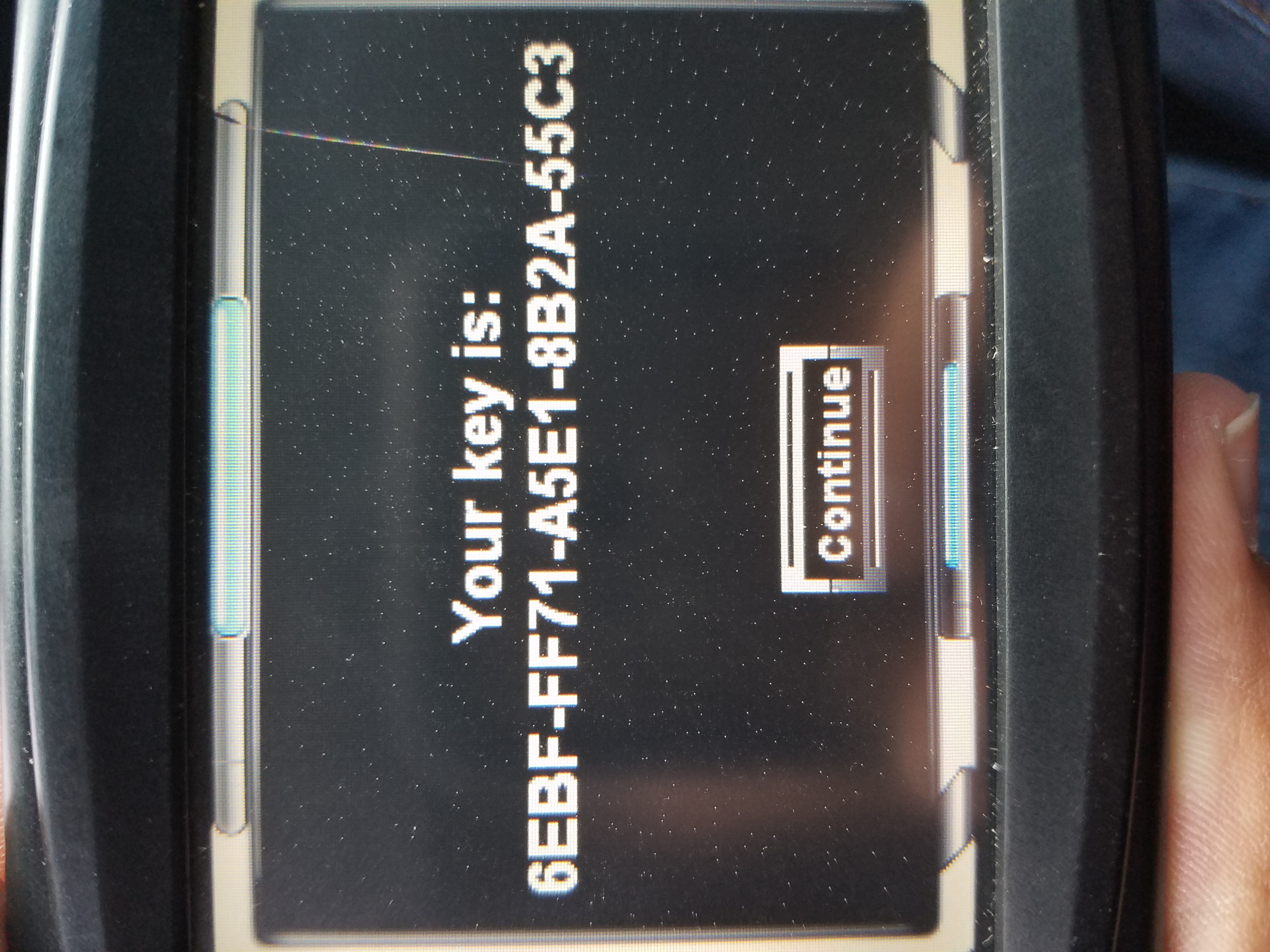

It says that the function isn't available. I can get my KEY I'D but can't do a force calibration
- 20170306_115137.jpg (3.42 MiB) Viewed 13836 times
- Posts: 58694
Re: Can’t tune SRT4 PCM
you have toi be plugged into the vehicle.

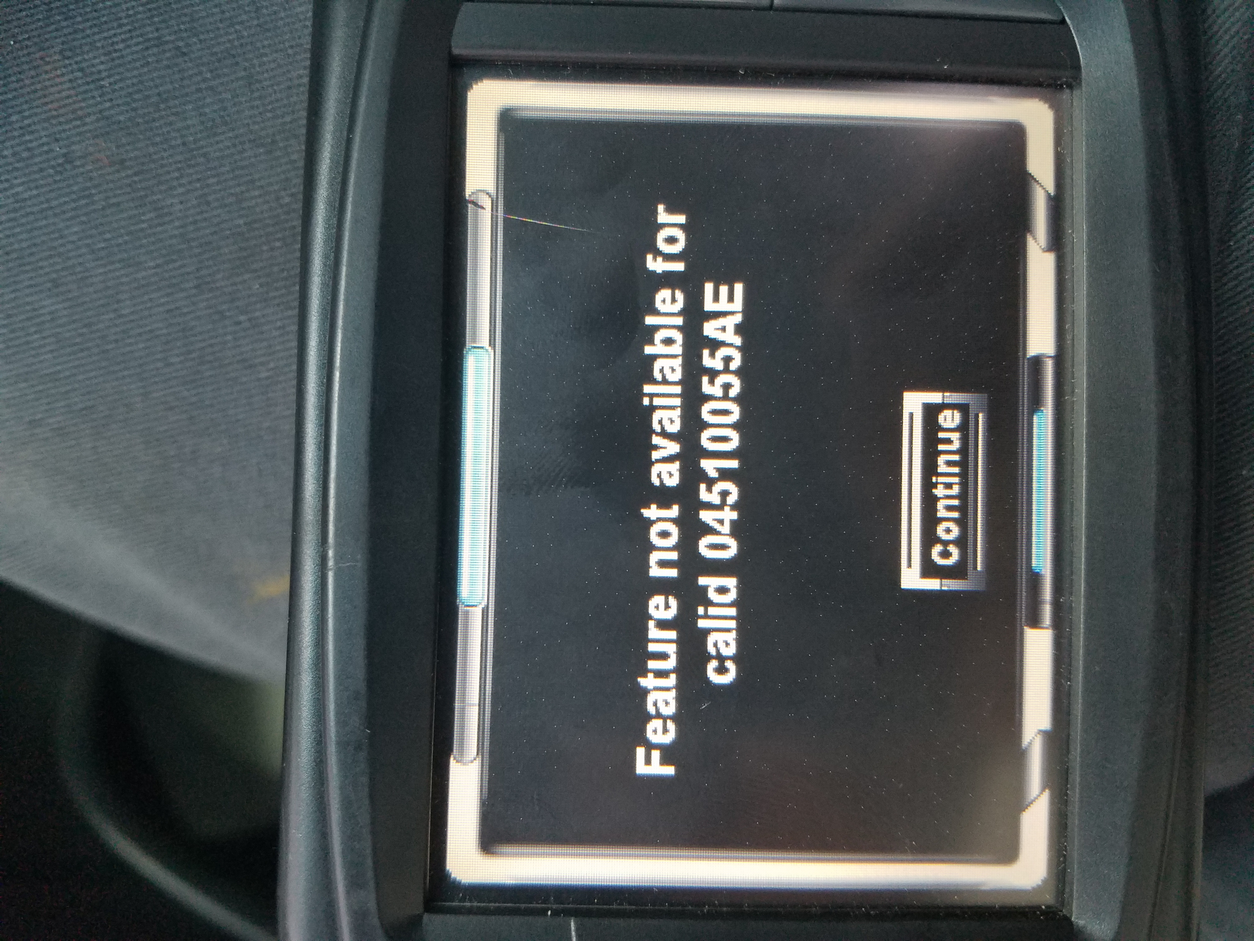

Calid is 04510055AE
When I go to force calibration update, it says. Feature not available for calid etc.
- 20170406_141139.jpg (3.81 MiB) Viewed 13834 times
- Posts: 58694
Yeah, thats a stage 1 pcm calibration, cant do anything to get that back to stock with trinity unfortunately.
