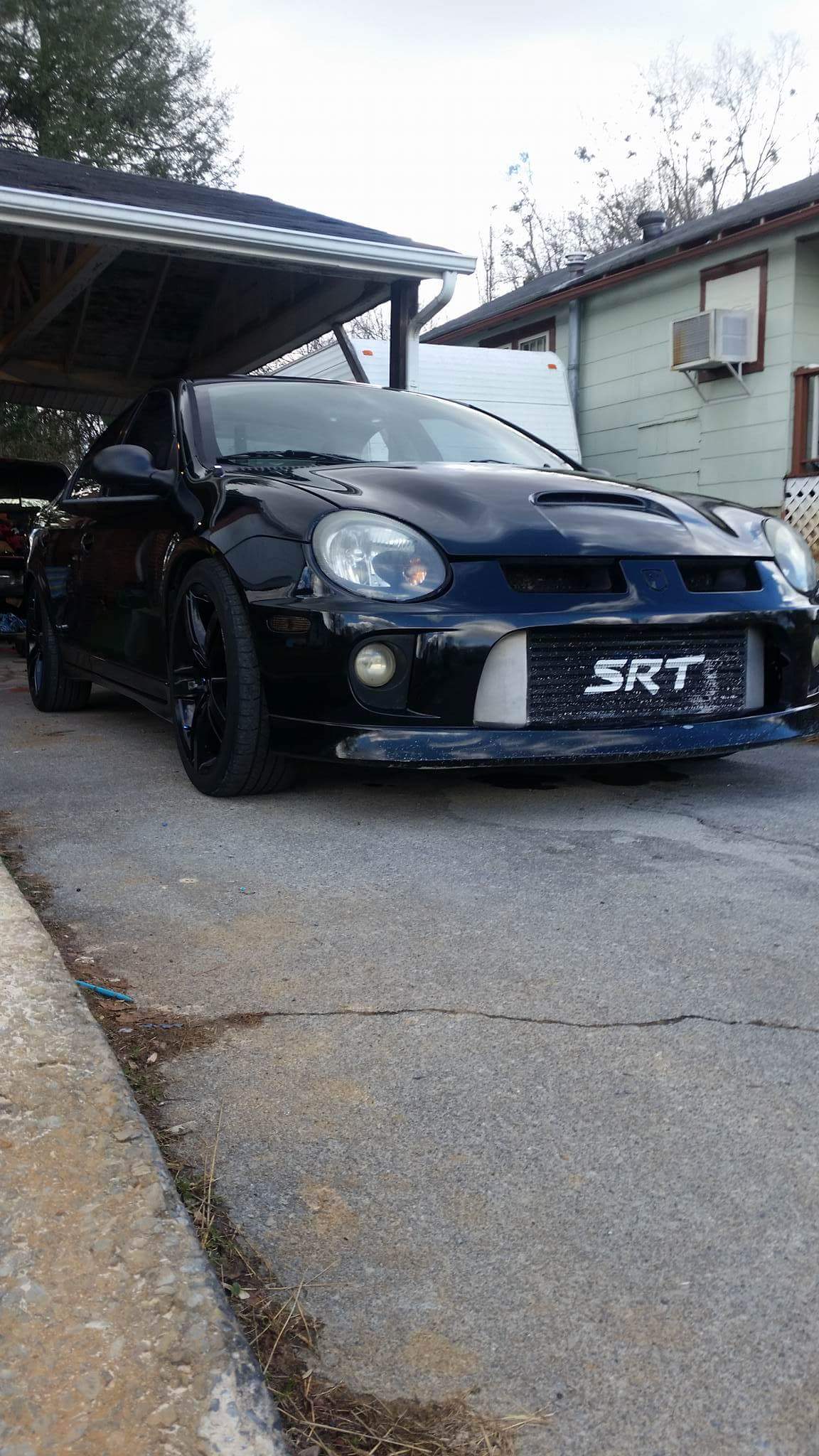

So I bought the Diablosport trinity because I heard it would help eliminate some of the lights I've been getting on my 03 neon srt4. I have a agp wastegate and bought the 8lb spring which is equal to the stock wastegate and hooked it back up to pcm controlled boost. I lost about 2lbs of boost by doing this but I figured I'd prefer the tune so I had to. Now was driving today really testing it out with the tune and it was great I felt the difference. Perfectly fine at high speeds and what not then I'm cruising at about 75 and boom here comes the light again so I checked it and it was the p1188 which I've been getting for about a month now. I used to occasionally get the p0234 which was an overboost code but that seems to be gone but the p1188 is what trips almost every time I drive it. It always happens when I'm cruising and there's just a little bit of boost for a couple seconds. I know what the light is but I can't seem to keep it off, just when I think I've fixed it there it is again. Help and suggestions would be much appreciated.
Also I replaced the tip sensor so it's not that and I've checked all my vac lines and I don't find a leak anywhere so I'm lost now. :blowup:
