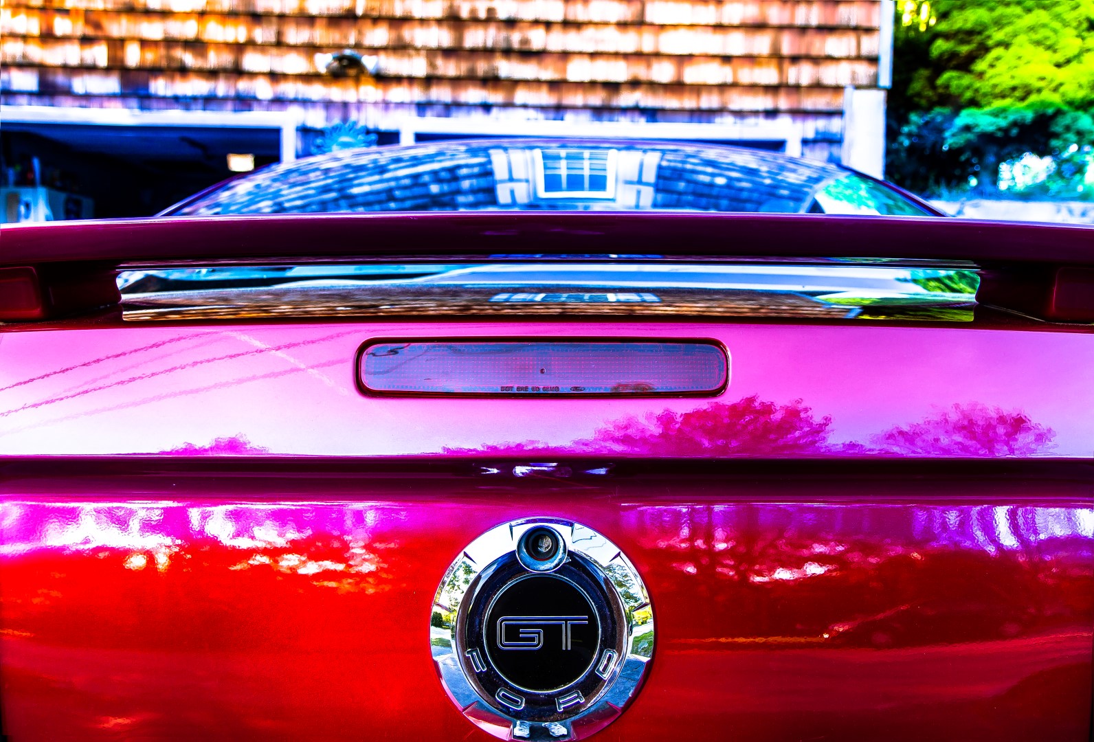

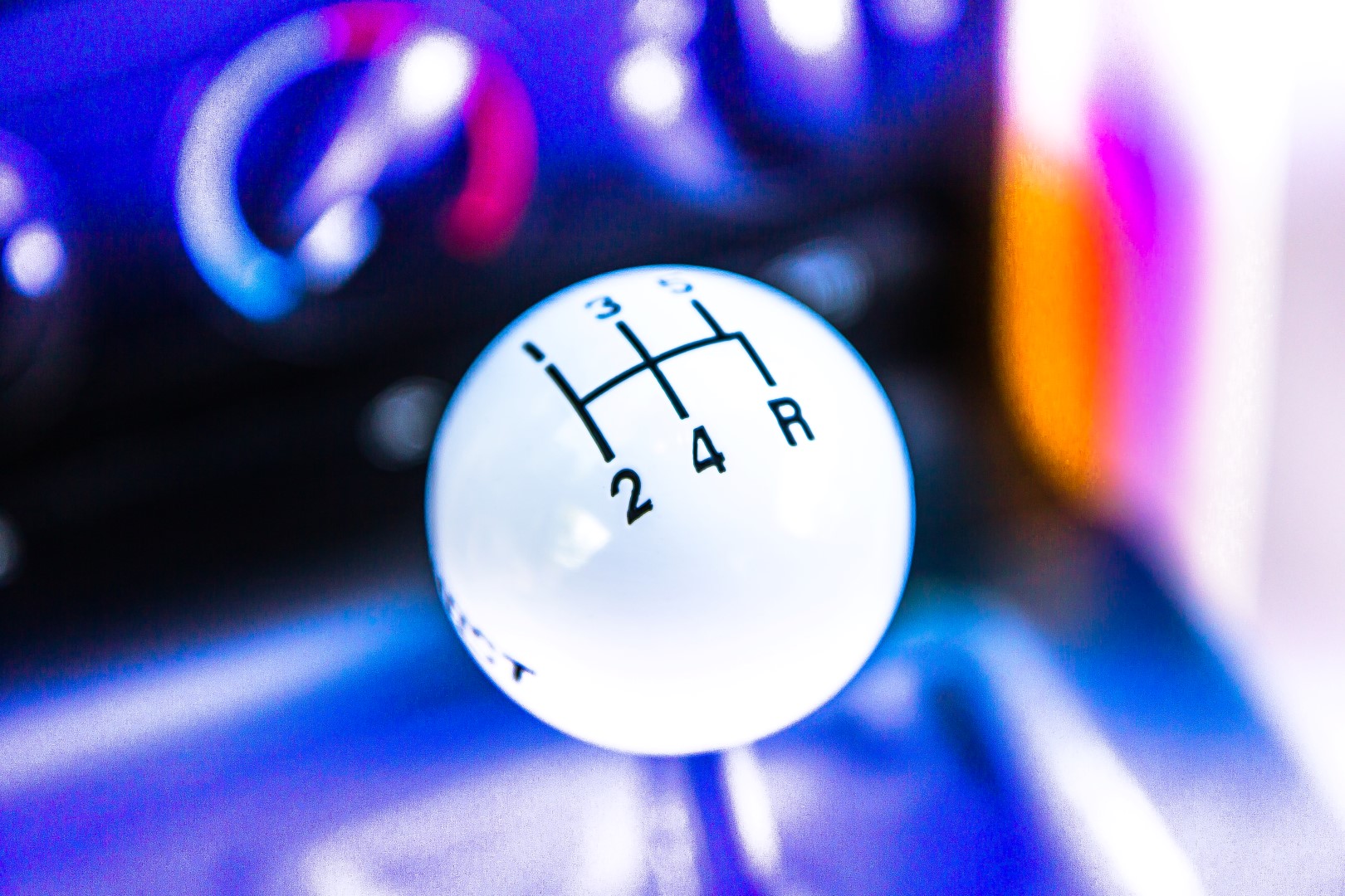

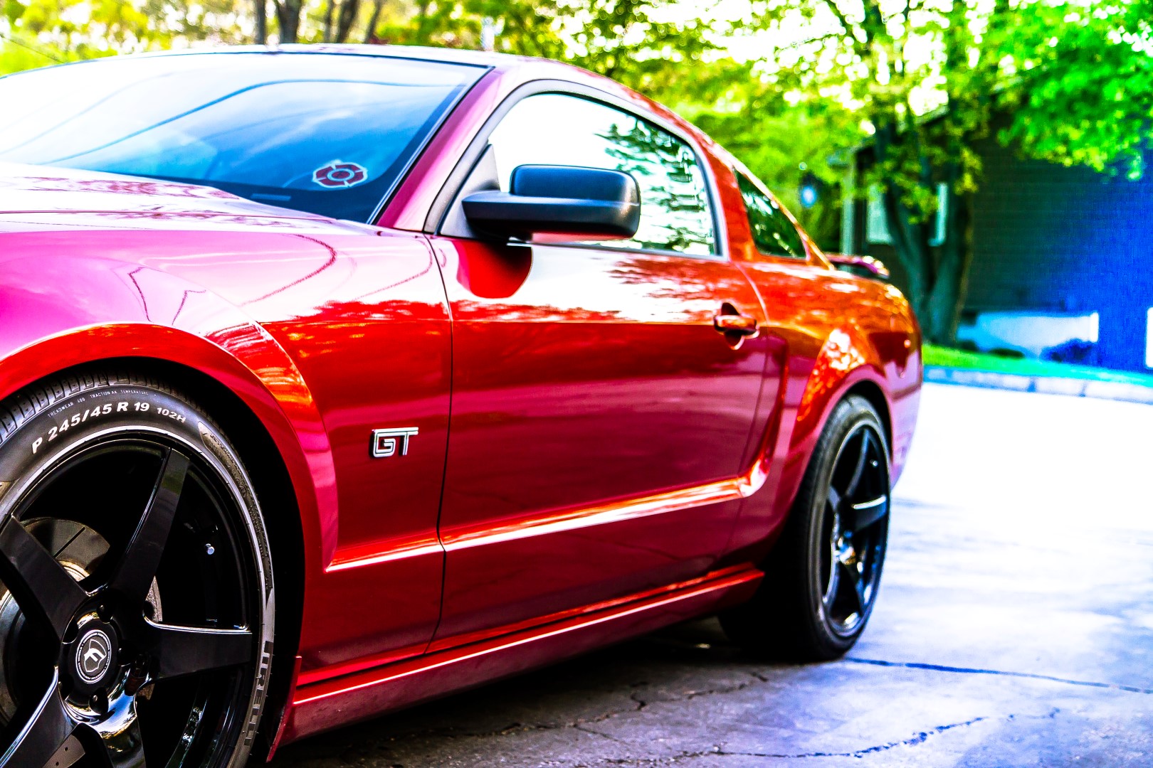

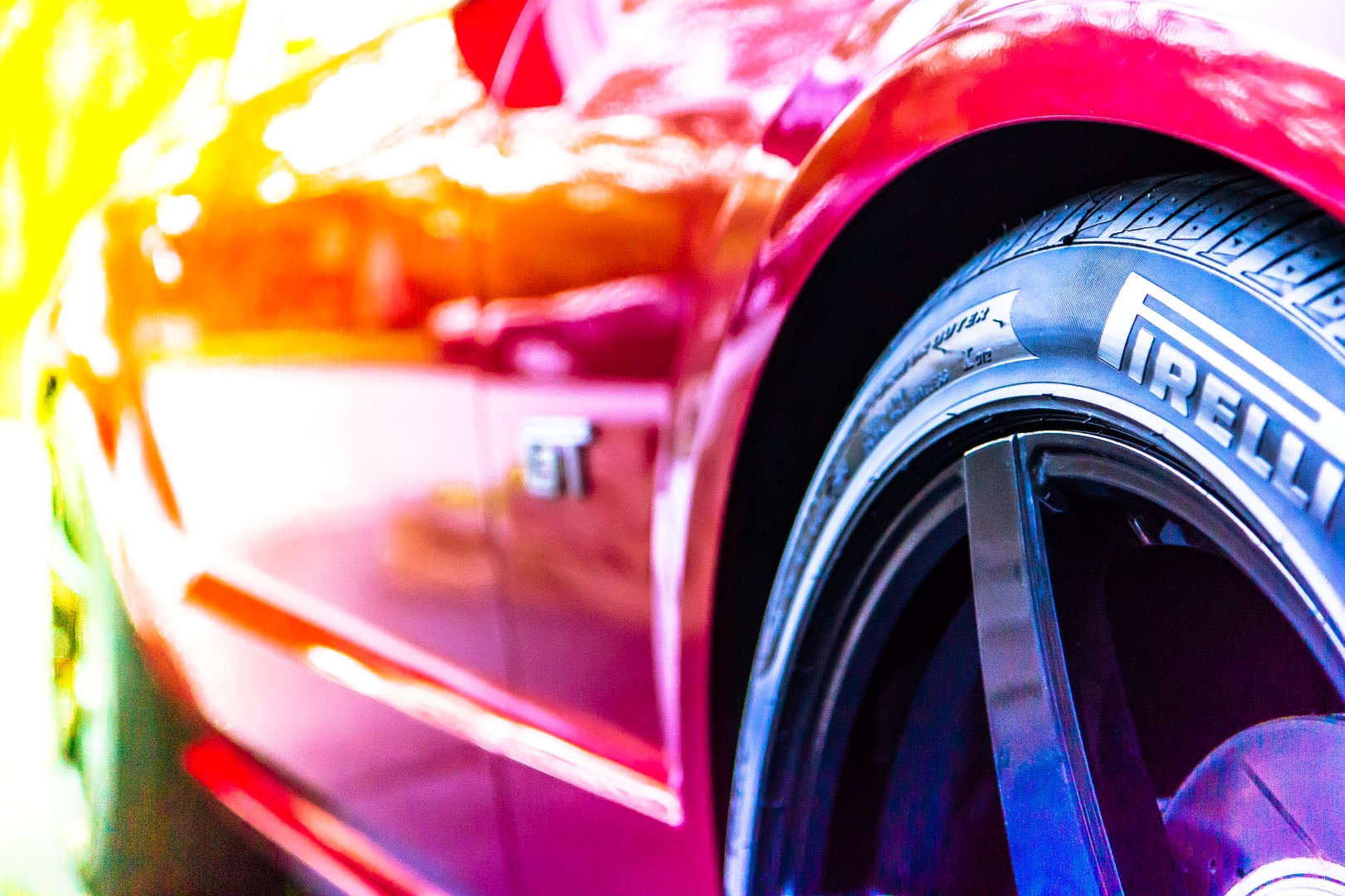

Here is my Mustang. Her name is Scarlett.
