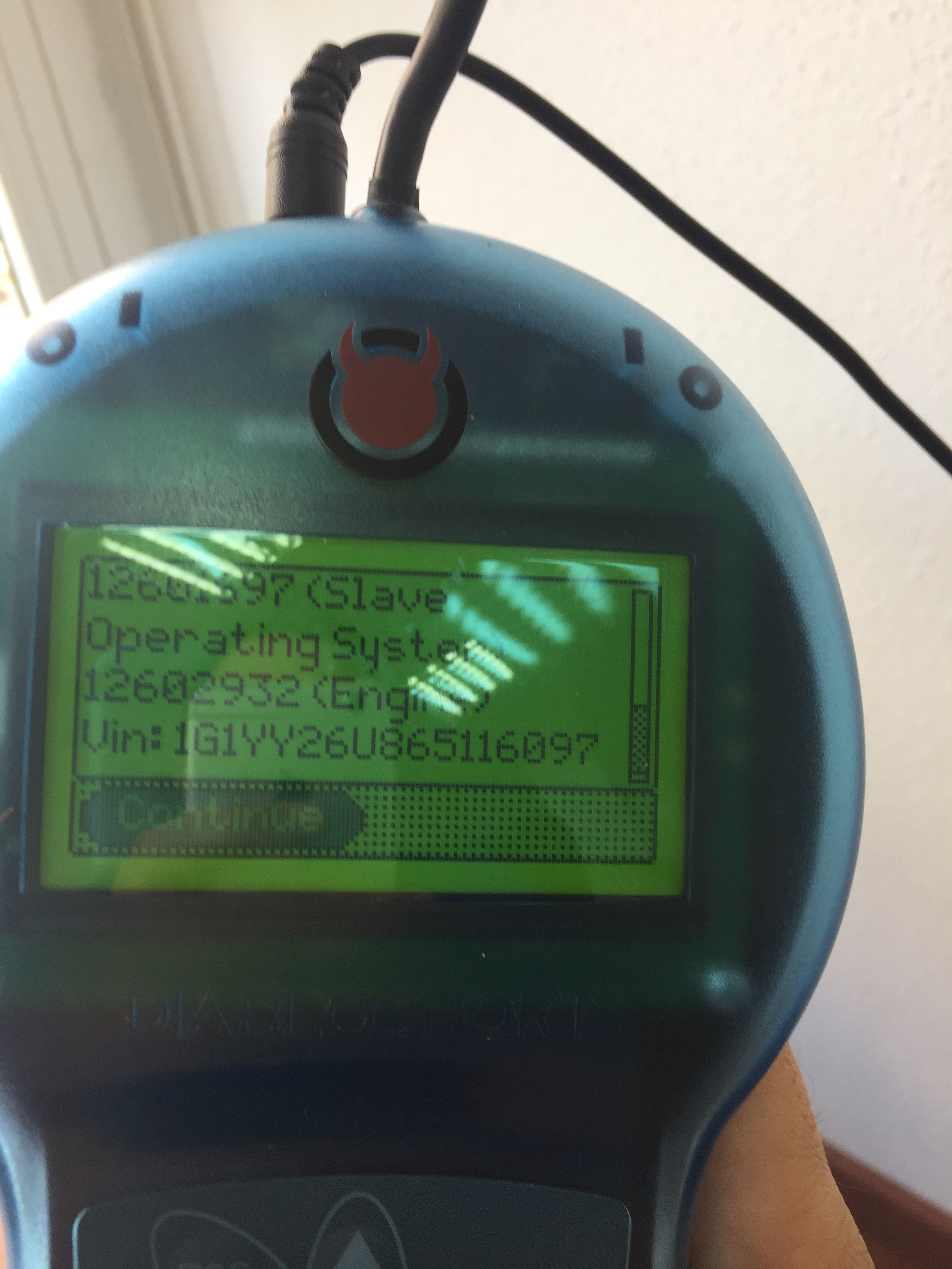

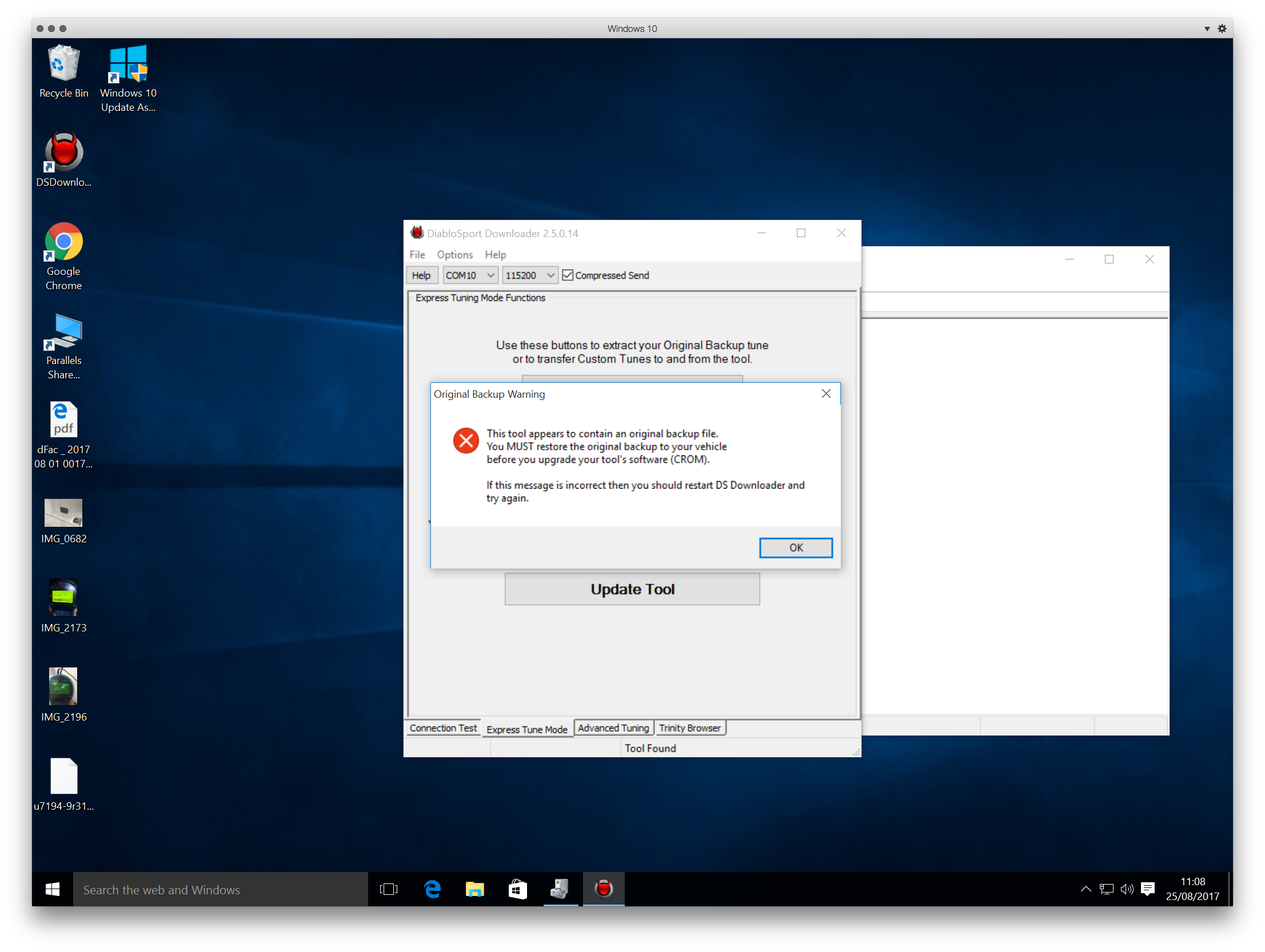

Hi, when I try to update the tool I get an error message (attached pic). And if I go under options -> Show last tune written -> Original backup at the end I see a VIN number that is not mine (pic attached). Maybe the tool is locked??? Thanks a lot guys.

- Posts: 58701
Re: PROBLEM WITH PREDATOR U7194 ON 2007 ESCALADE ESV
you need to plug it into the vehicle and restore the original backup then it can be updated.
- Posts: 58701
Oh, if you bought this used, its married to another vehicle, it will need to be reset for $129.
