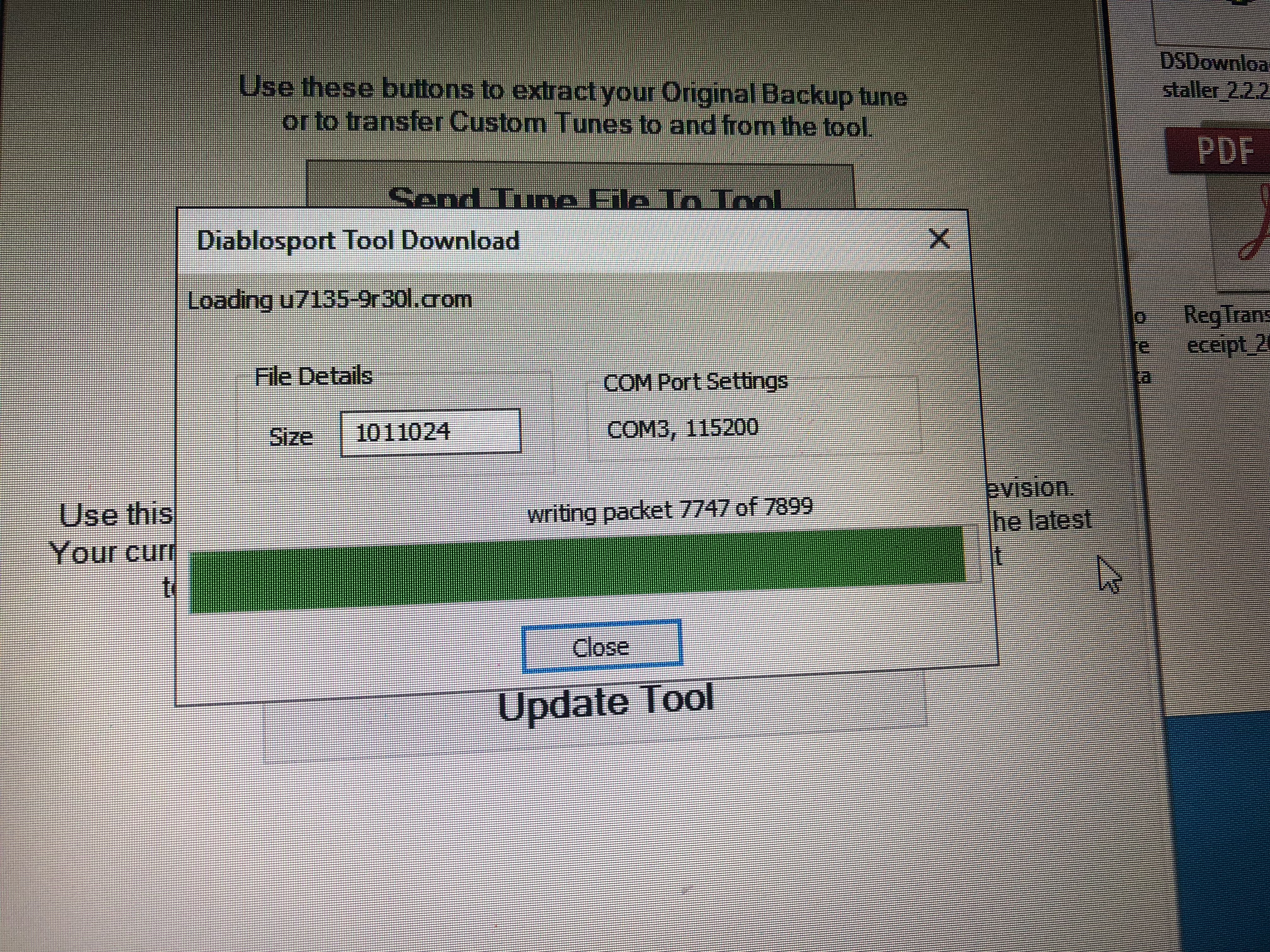

Tried updating to 9r30 crom last night and it got about 3/4ths done and then got an error message on the tool saying something to the extent of "could not copy crom image". Any ideas why? Current crom is 9r281 and hardware is UNI-REV2.

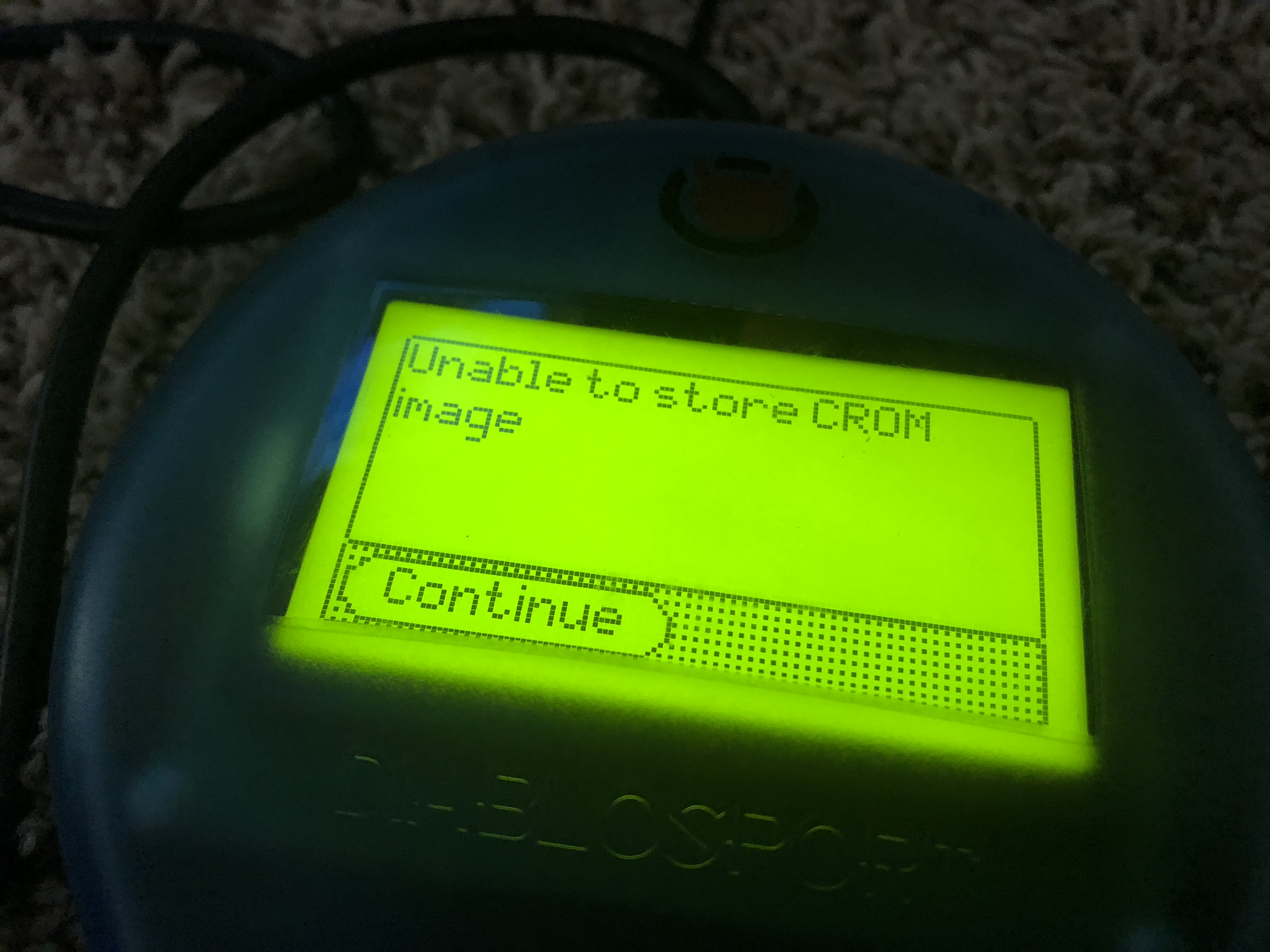

See attached pics, this is the error message and where the downloaded stops.

And now my predator is giving the “application is missing or corrupt” error. Tried updating it with the 9r28 crom and it’s doing the same thing g as when I try the 9r30 crom.

Well 9r28, 9r30, and 9r30l didn’t work BUT 9r28l did so I have a working tool again. Sucks I can’t update to 9r30, really wanted to have the adjustable shift points.

I’ve tried 9r30l previously and got the “unable to store crom” error
