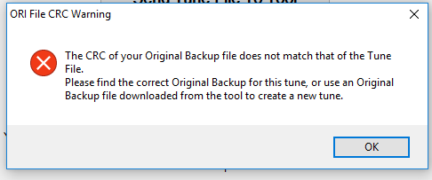

Re: 2016 Ram 1500
i wasnt able to get the tune on the trinity keep getting this error message. also included the original backup file
- PCM_68265855AF.drg
- (126.13 KiB) Downloaded 298 times
- Capture.PNG (8.18 KiB) Viewed 9304 times
- Posts: 58777
Re: 2016 Ram 1500
use this one.Juanm3700 wrote:i wasnt able to get the tune on the trinity keep getting this error message. also included the original backup file
- PCM_68265855AF_no_ABS_ESP_TC_new.drg
- (98.89 KiB) Downloaded 302 times
