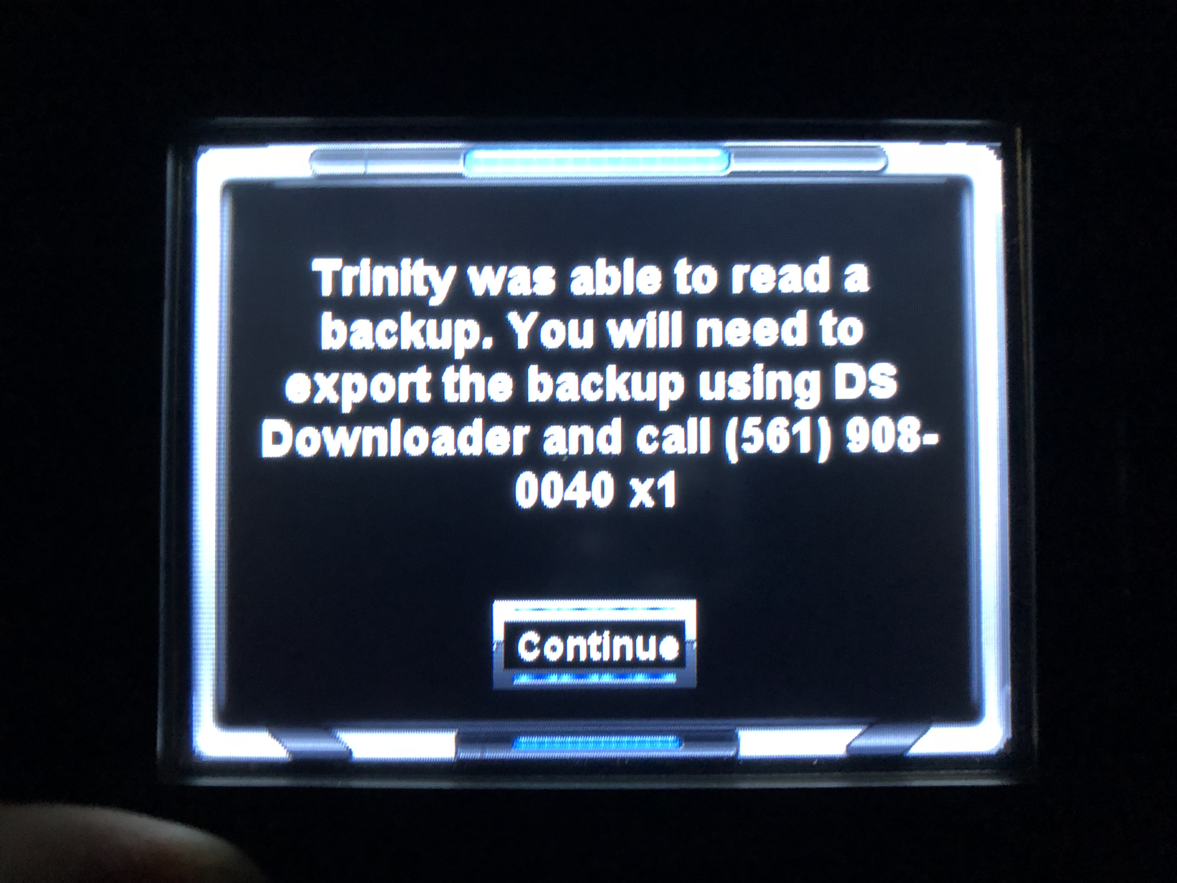

Good morning, i would like to ask for a help in the issue i am facing when i try to use the Trinity to tune my 2017 Silverado 5.3 L
when i try to install the tune, the trinity save the backup and after that when i click on performance to install the stock tune and modify it i got the below message " Trinity was able to read a backup. you will need to export the backup using DS Downloader and call (561) 908-0040x1 " ( Attached is a pic of what message i got.
I Hope someone can help me in this issue.

Any one can help me in this issue please ? , attached is my pcm backup file
PCM_677878686062.grg
(1.81 MiB) Downloaded 547 times
Posts: 58782
Re: 2017 Silverado 5.3 L Tuning issue
we'll get this added asap.

load this to the trinity then you can tune it.
Sorry for the delay.
trinity_gm_can_gas-1t14ab_update.crom
