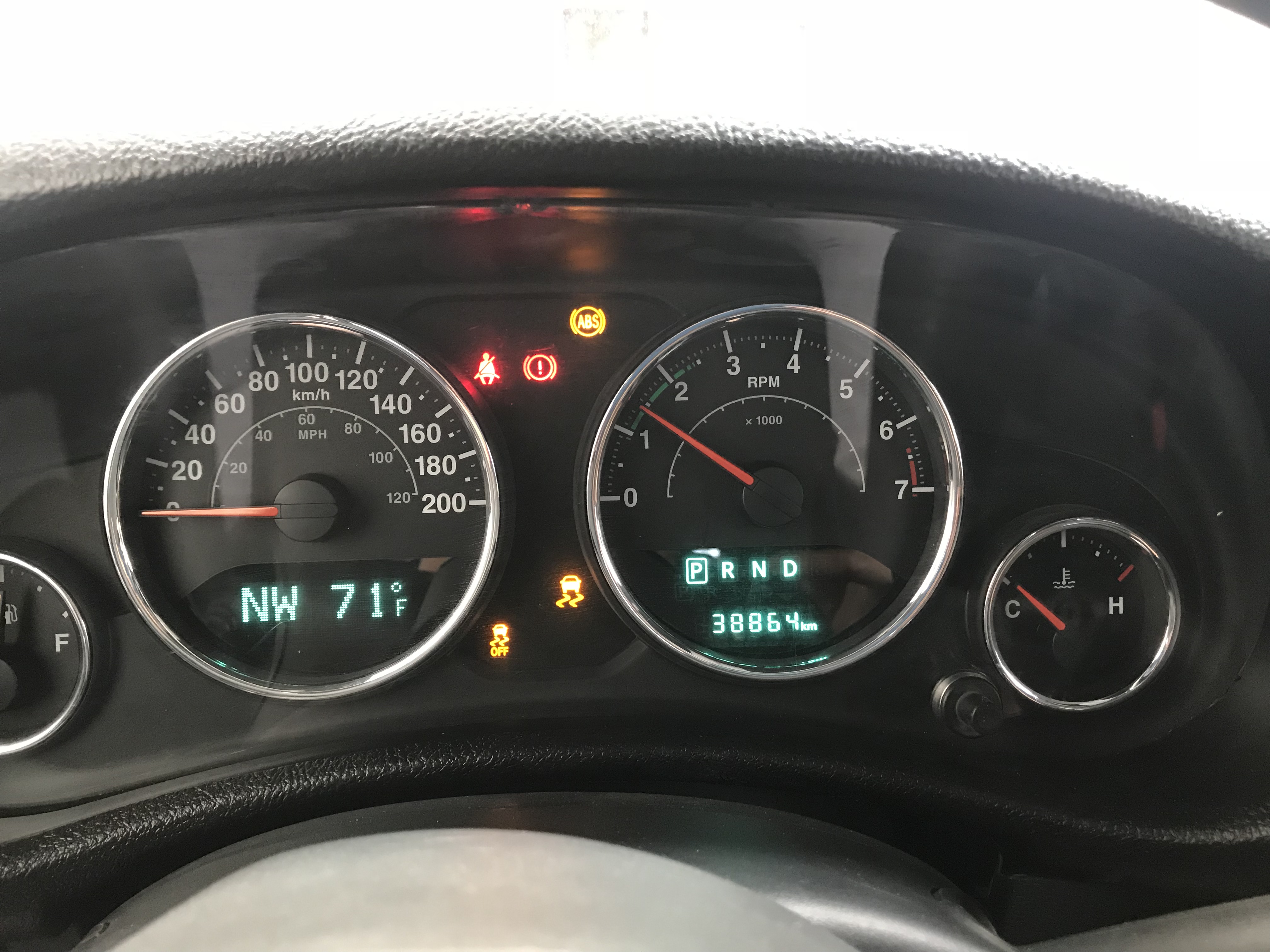

Below photos show the car in the three modes:
Car powered on with 93Oct tune
Car on ignition but not powered on with traction disabled
Car powered on with traction disabled
As you can see when powering on car check engine turns off, when I start my sand offroading check engine comes back in and performance degrades in car along with inability to manually shift my automatic gearbox.
Is it also normal that hand break light shows when disabling traction? The physical kill switch at my friends car doesnt light up the handbreak.
Appreciate your support to solve my issue.
