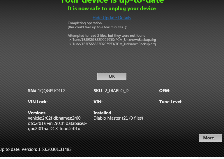

I was adjusting the timing on my tune when the write failed (full battery, my predator talks to PCM no problem...just this I2 that is dropping the ball). I got the original backup restored (does me no good though since car has big injectors and map sensors). It seems the I2 doesn't acknowledge the PCM; won't read the vehicle.
I tried to update via wifi (no updates) and tried to do it through ignition where I get the attached error.
I noticed in the other threads DS staff would provide customers with a new DRG file that seemed to get them back on the road. If I could get one of those DRG files too that would make my day. Thank you
Vehicle not supported; cant read vehicle

- error.PNG (277.02 KiB) Viewed 14419 times

They reset the tool; it then spoke to the car and uploaded my custom tune. However at the end of the write process when I cycled the key I didn't hear the PCM kick the fuel pumps on. Tried to do a Force Calibration but it said an unexpected error has occurred.
Tech support told me to d/c battery and hold down brake pedal for 5 mins and retry. Get same problem of I2 saying the vehicle is not recognized and that I need to update the I2.
I have attached the latest INFO.XML file below. Please help; this DS product is holding my car hostage.
