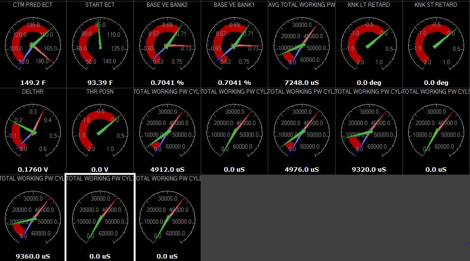

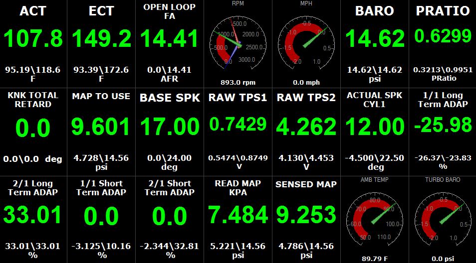

After going through the logs i noticed that when the truck goes @ WOT the AFR gets @ 11.12/13.70 the LTFT STFT get smoother and almost perfect closer to 0. please check my log labled " Highway driving part 1"
Strangely enough on the "Coldstart log" some injectors stop working noticed that takes place when AFR is @ 14:41 both STFL 1/2 are happy with a value of 0. please check the attached images.
