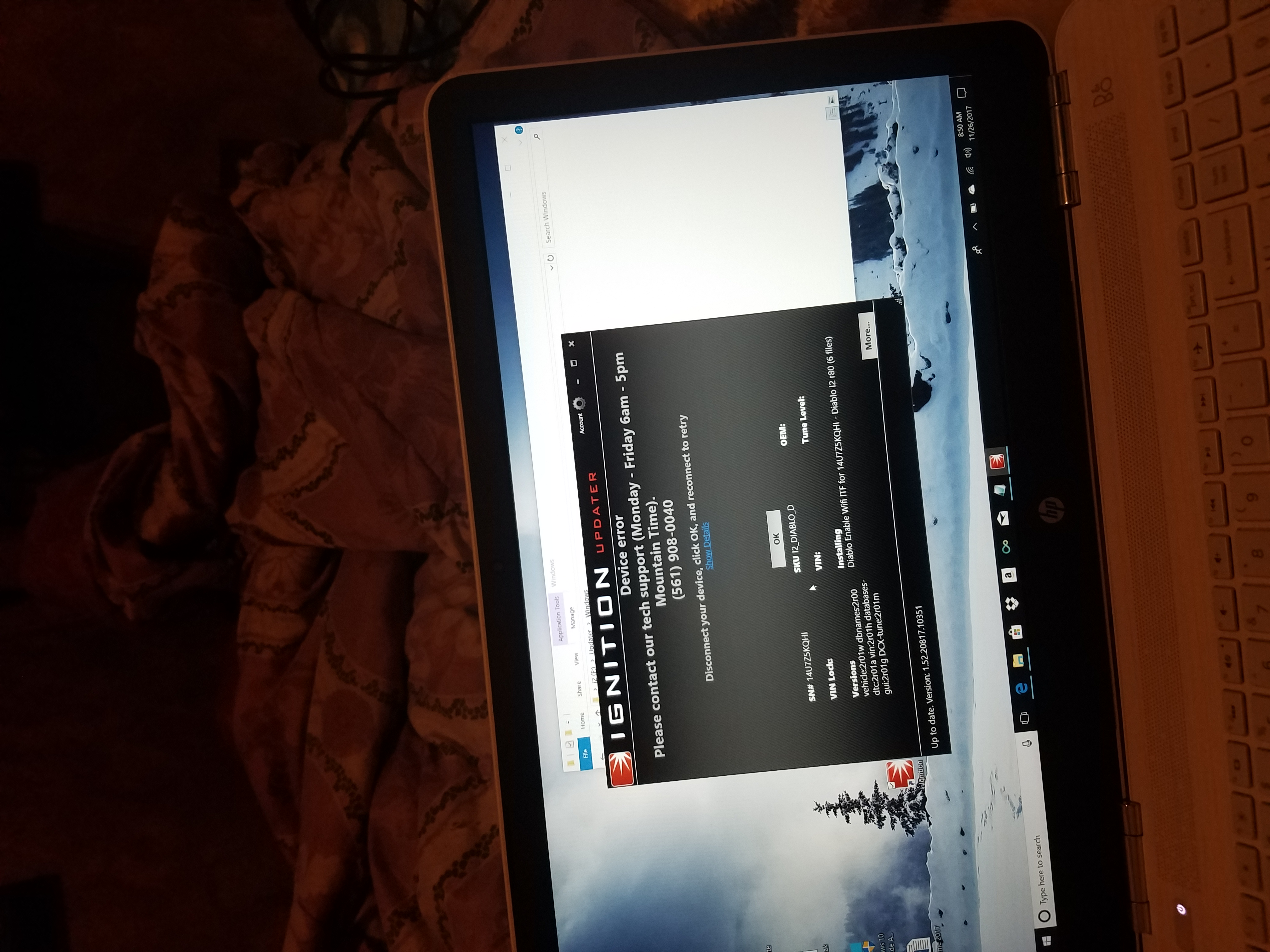

When I tried to use the Ignition Updater I get the device error please call technical support under details it says Device SKU cannot be determined.
I then tried to just double click CD Drive Diablosport, it updated something rebooted the device and now says An unexpected error occured: Tool OEM is missing Parameter name: oem twice. Is there anyway you could help me get this updated?

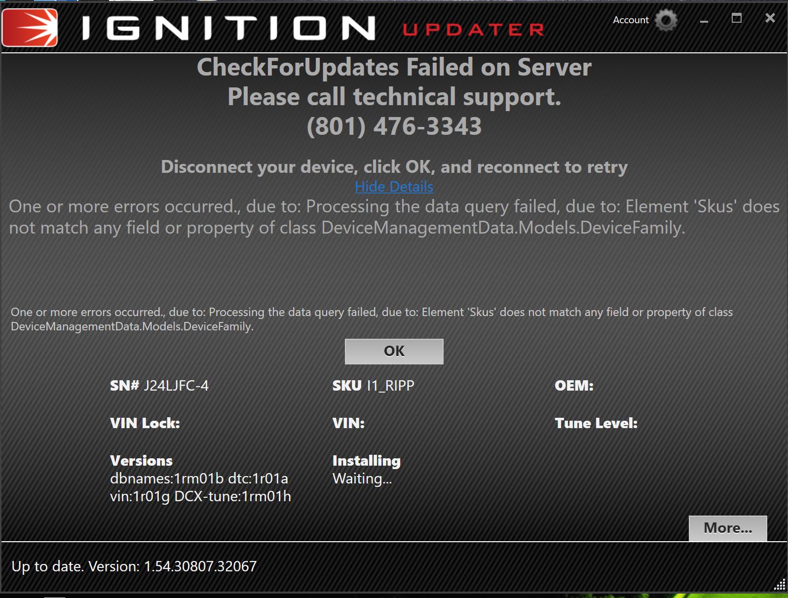

ignition error.jpg (280.18 KiB) Viewed 9851 times
Posts: 58771
Re: Issues updating intune
Preston5280 wrote:Hello
Is there a fix for this? I am having the same issue and need to update my tune to the latest for an emissions test.
Info.xml attached
Any help would be much appreciated.
this device is up to date.
