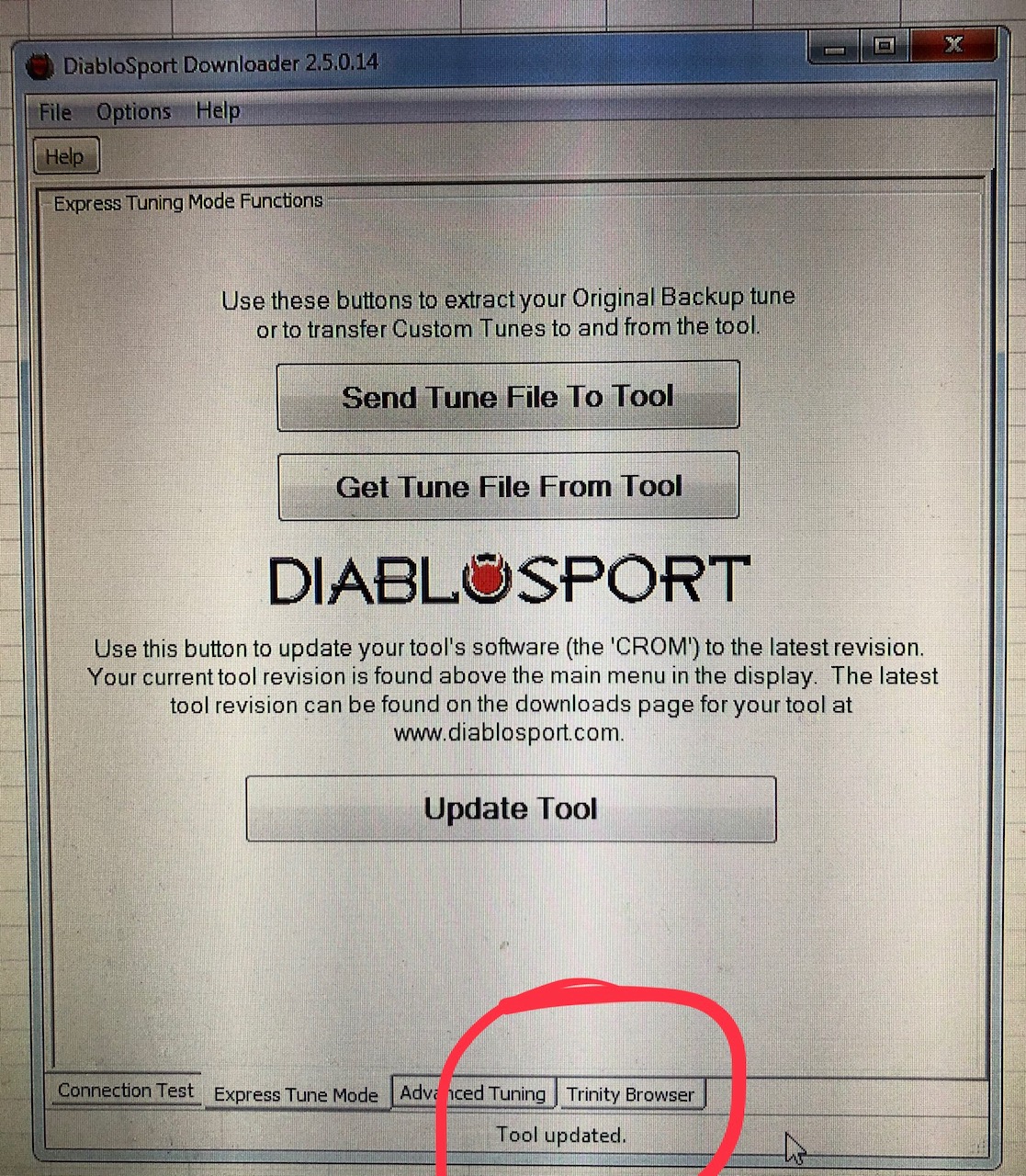

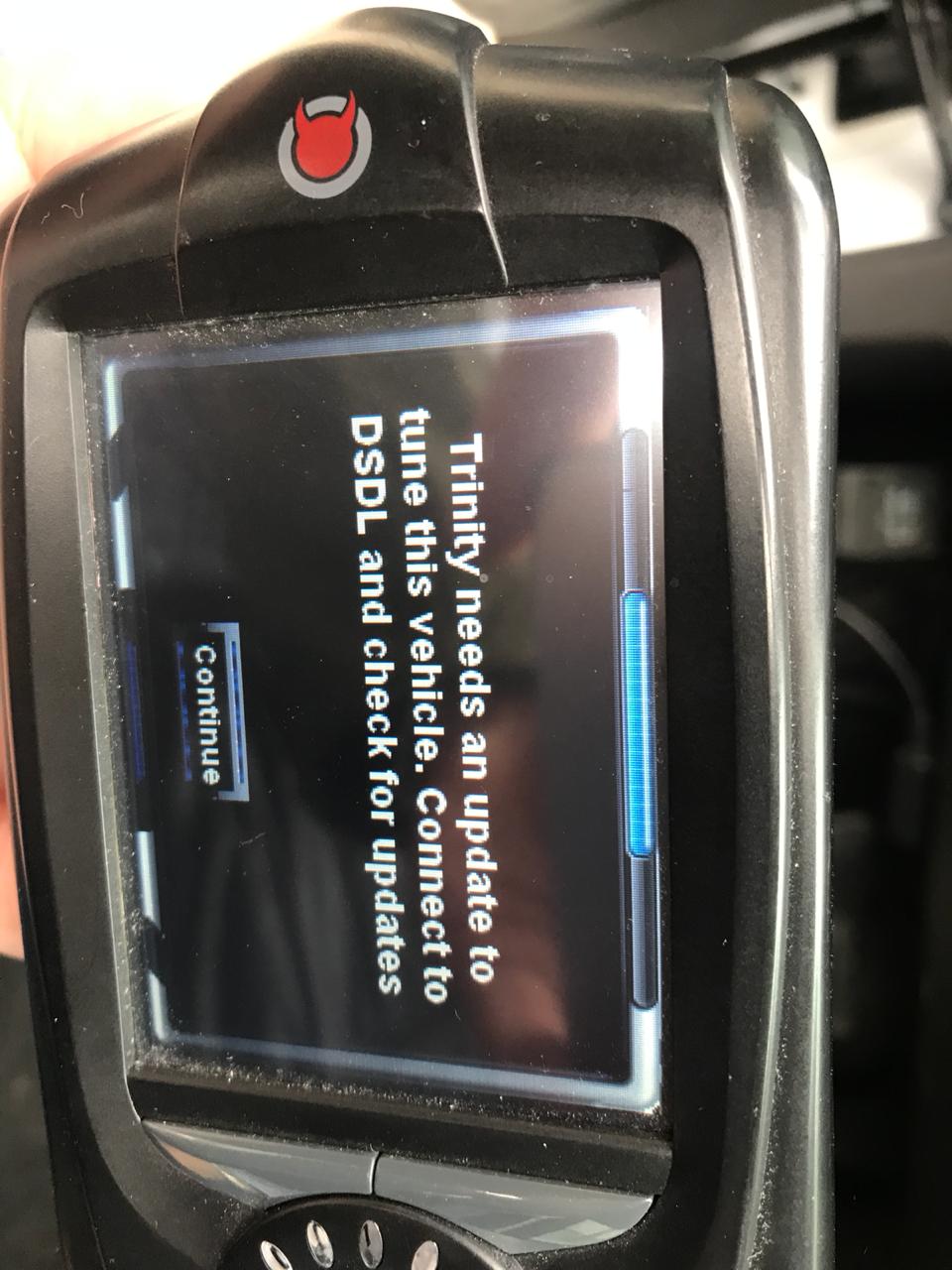

I sold my F150 , so i tried to use my programmer but it don let me , i updated it to gm crom , but i think that it have another file atacched to ford , it keep showing that the tuner needs to be updated via dsdl it have the latest gm crom but when it reads the vin says it need to be updated

Yes i did , the programmer shows Trinity not married yet / Nothing to show i also used .frg files in the past , wondering if this is not causing the problem?

2018 6.2L i did several updates via dsdl but nothing once i select model and engine it shows tuner needs to be updated

IT DOES NOT UPDATE EVEN WHEN THE DSDL STATES UPDATED

2017/2018/2019 vehicles require a special unlock sequence...
With the newer inTune i3 and Trinity T2, what will happen is, when you go to install a tune the first time, the tool will give you a message that "one or more controllers can not be tuned - Contacting powertech for vehicle unlock... you will be notified within 1-2 days" - or something similar to that effect.. so then in 1-2 days (usually within an hour though) you should receive an email (if you registered your tool on diablo's site) that your update is ready.. so then you'd run the Ignition Updater on the tool again, and it will update the tool with the unlock code for your ECM, and then you'd be able to tune the vehicle.
But with the old Trinity T1000, I'm not sure it works the same way, since that uses the DSDownloader program and not the new Ignition Updater program...
Contact [email protected]
