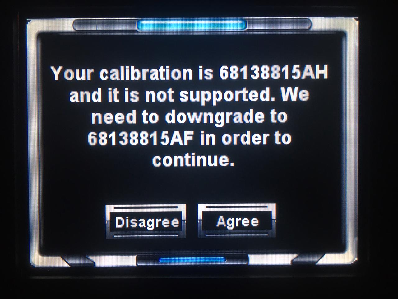

So I plug my trinity T1000 into my 12 Jeep wrangler JK superchargered with a magnuson TVS1320, and it says my trinity is not supported. Says I need to downgrade to version AF instead of AH... how do I go about doing that??? Please help me!!!

This is what appears on Trinity

could the vehicle have been flashed by a dealer since you last programmed it?
I dont understand how its suddenly not supported if it was married to this vehicle.

Yes it was flashed by a dealer and after that the message appears. So what do you recommended to do about it

you'll need to give us a call to have the device unlocked.
if you go to the dealer, put the stock tune back in the pcm first :)
