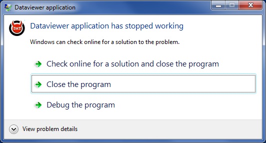

I went to use data viewer for the first time in months and it suddenly it crashes on start. I've used it in the past without any issues and can't figure this out... any help troubleshooting is appreciated!
System is Windows 7 (64 bit), no major hardware or software changes have been made since I last (successfully) used DataViewer
Had previously been using 3.4.3.1. Tried to remove and reinstall, then removed 3.4.3.1 and installed 3.4.4.21
Tried running as administrator and different compatibility modes
I've attached a pic of the generic error message that pops up, these are the error details:

Just to follow up in case someone else has this same issue... It ended being my (Zone Alarm) firewall which suddenly decided to completely ignore my settings for this program and would not allow it to execute no matter how many times I tried to set a new rule!
