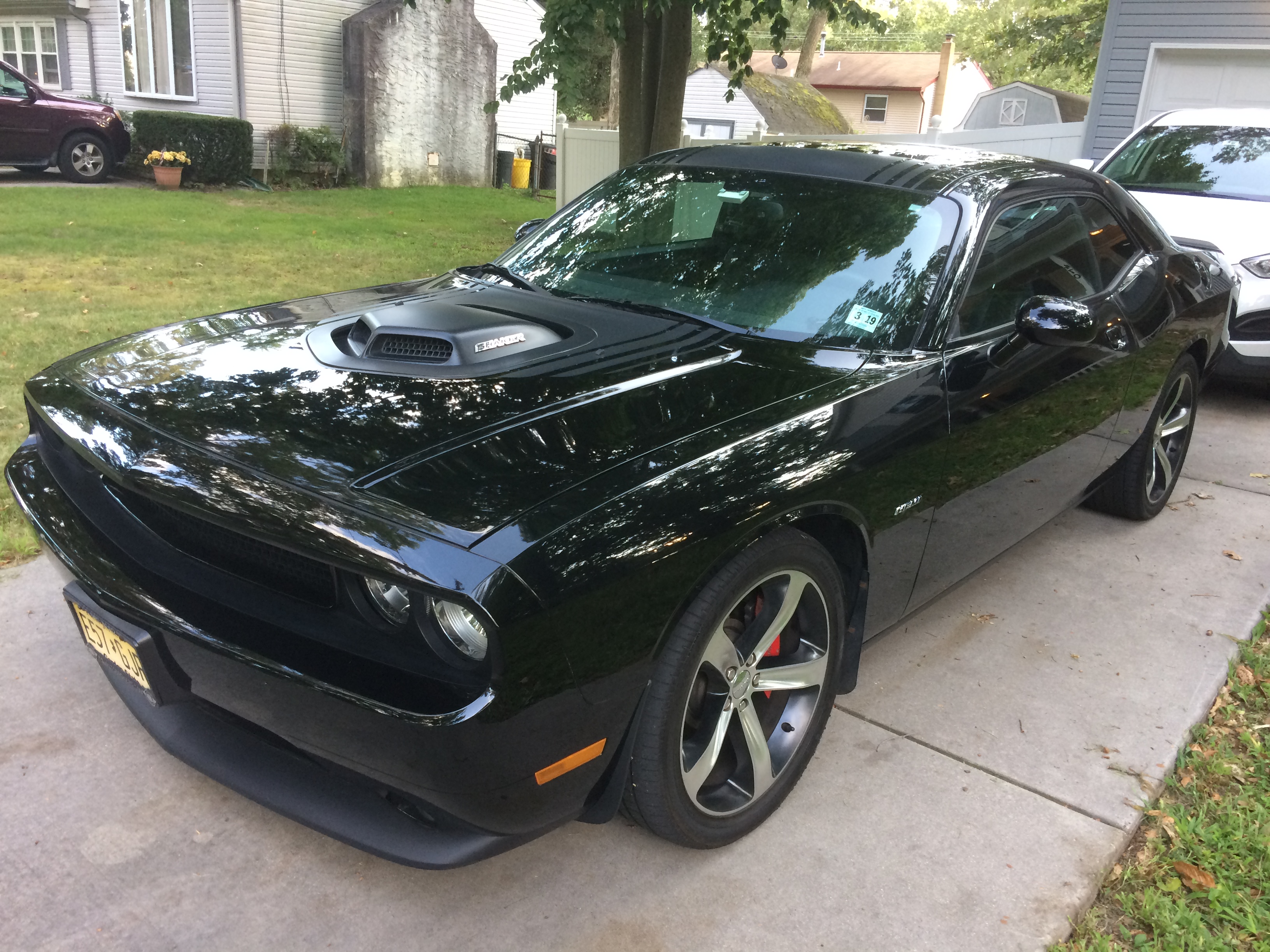

Hello,
I am new to turners so I need something on the simpler side I can figure out. I have been doing my research but there is so much information out there, I am not really sure what to do. I have:
2014 Dodge Challenger Shaker 5.7 automatic with exhaust, everything else is stock and I run regular gas.
Upgrades I’d like to do: Tuner and larger throttle body.
What Tuner would you recommend and would I need to change what grade gas I use? Thanks! :D
