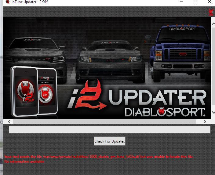

Re: 2011 caprice
Hey Mike, when I try to update I get this message (attached file). I have downloaded and added the registration file to the intune drive that shows up when the tuner is plugged into the PC.
- Posts: 58778
Re: 2011 caprice
hmm, post the current info file.
