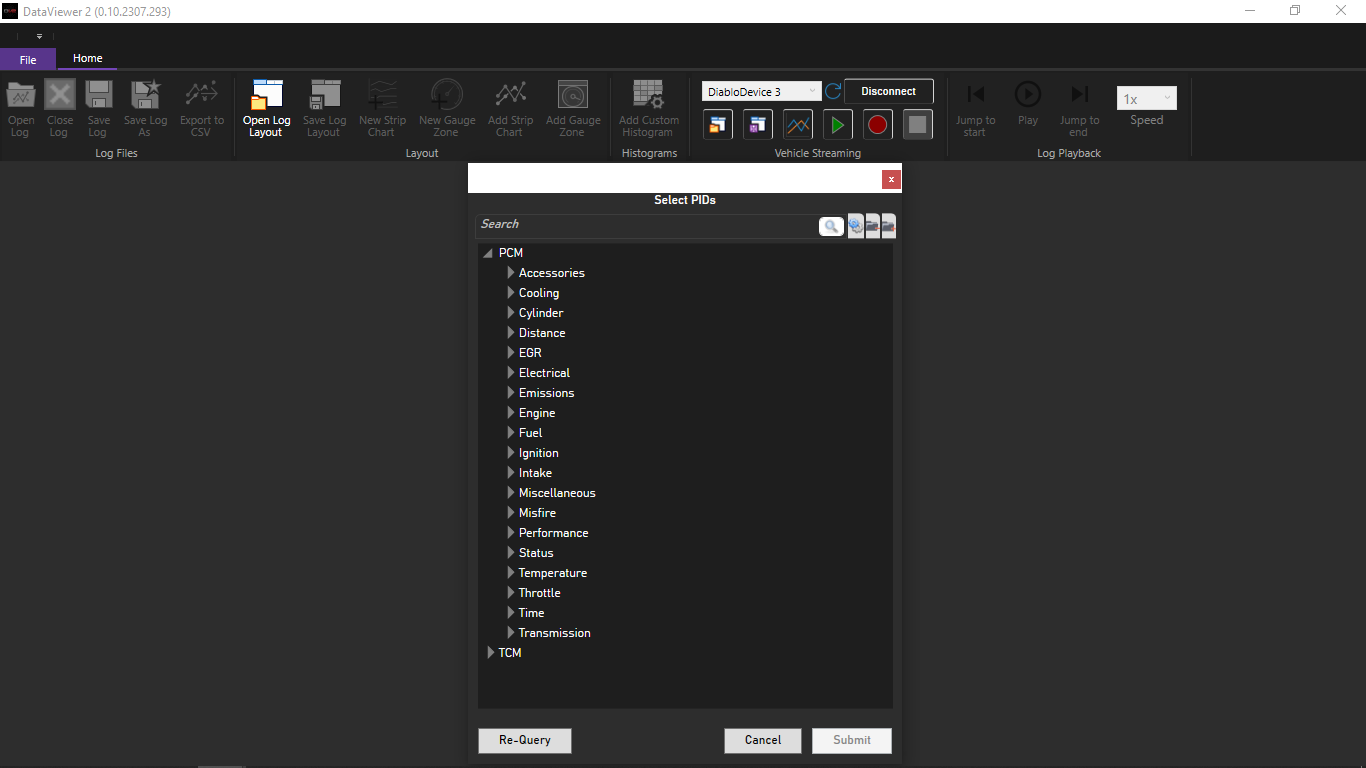

Good morning, I tried before with both, DV and DV2, at least DV recognize the EAS, but the DV2 does not, even after re-query at least twice, that is why I didn't logging using DV2. Attached you will find: the picture of the availables PIDs on DV2. A log using DV. A log using the Trinity 2 screen and the dashboard file I was using for the Trinity 2 HMI. I'm sorry, my be I'm wrong but I didn't see the point to do the log using DV2 if the PID wasn't there, please, pardon me if I wasn't right and let me know if you want the log anyway.

OK, for now streaming the EAS devices is not supported, you'll want to record the logs to the device then play them back on a pc.
